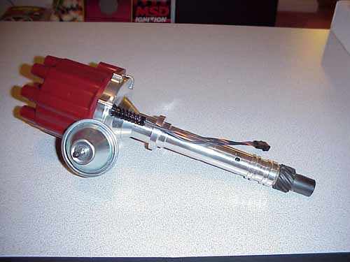

ronterry's Avatar
Joined: Nov 1999
Posts: 1,507
From: Elizabeth, Colorado
Car: '94 Corvette
Maybe this will help scale it for you.
Good luck on your project.
Ron
