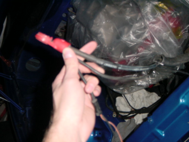

87 Formula, What wire is this that goes to the Starter(pic)
It looks like another Accessory wire, but theres no fusable link and its got the goofie end.

That's the Solenoid wire... the one that carries the power to make the starter to start starting..... goes to the "S" terminal on the Solenoid, which is the small one closer to the block

Ok I thought it was that black wire. Notice the Black our dark color wire I have hooked up to the solinoid, where does that go?

The solenoid wire should be purple. I don't know of any black wire down there unless there's a ground wire in your particular car, or unless it's the battery feed for some accessory such as an amp.
Might be worth checking which one of those 2 gets 12V when you turn the key to Start, before you button it up.

You can see the wire in that pic. See it its black and smaller, the one at the top.

The solenoid wire is purple. The wires that should go to the batt terminal are red, and have fusible links for their last few inches.
I can't guess what the black wire is. I'm fairly sure it's either not factory, or goes somewhere else. In GM wiring, black is almost always ground. Nothing else.
Yes, I'm sure. GM has been using that same color code at least as far back as the 50s.

See but those wires the big one shown and little one go to the positive side of the cable. Heres a pic.

I apologize... I see that the thing youhave there is the battery cable. I'm sorry, I'm an electronic person by trade at this time, and things people do to their wiring bother me greatly.
Of the wires in your hand (that terminate at the battery), the big one goes to the starter (duh); the real small one with the Weatherpak connector is power to the ECM; and the mid-size one goes to the alternator.
The purple wire still is supposed to go to the "S" terminal of the solenoid.
Do you perhaps have the alt wire connected at the starter?
