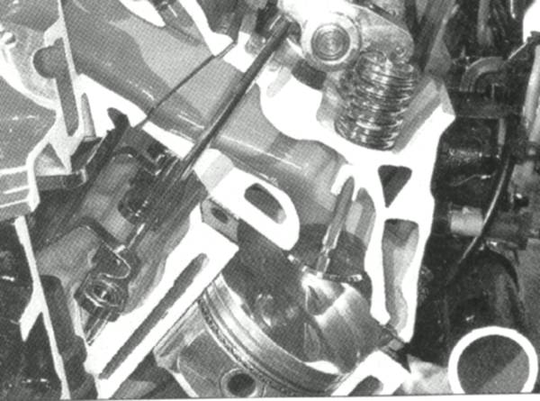

Although the LT4 intake is designed to fit the heads, and had a better injector positioning and spray angle, the LT1 intake upper flange has adequate material to raise the upper port opening to fit LT4 heads. The flange gets "interestingly" narrow, but will seal. I raised the port roofs and openings on LT1 heads and matched the intake to fit. The ports ended up at 197cc fom the 173cc starting point.
