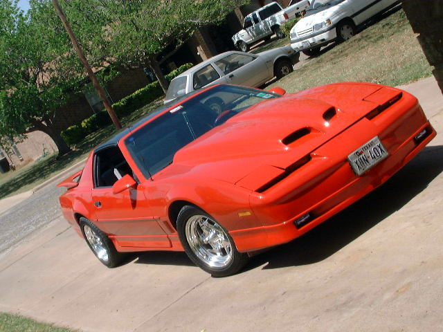

bottom
much easier from the bottom...

ramps..
LOL.... hahahaha... ramps.... wish I could use ramps that would be much easier... Ever tried driving a lowered T/A onto ramps.... It's good for a laugh Ive tried.. Or even one at stock hight for that matter... Sorry I just rememberd the first time I tried to use ramps on my car so I had to share...Later
