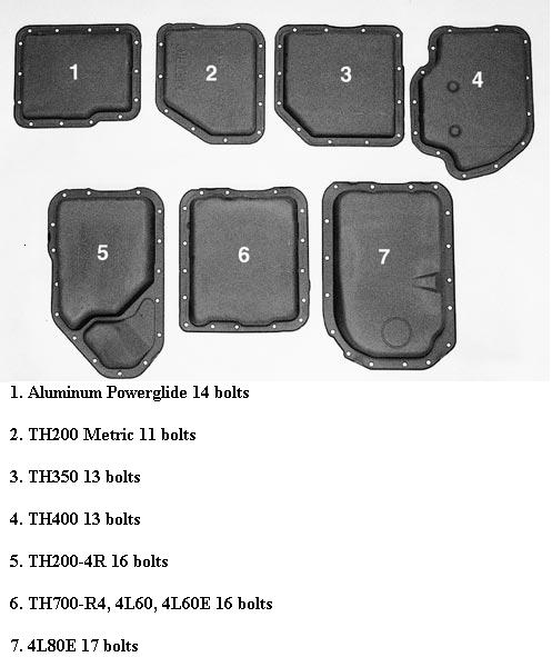

does anyone have a picture of a th200c tranny pan? becuz i know my tranny is a th350 but now u guys are mentioning that the th200c is just like the th350. now the th350 tranny has the pan with a corner cut off i think its the bottem right if ur lookin at the back of the tranny. but does the TH200c have overdrive? if so then im pretty sure i have a th350 in my car.

Just look and see if it has a vacuum modulator if it does it is a TH350 if it doesn't it is a TH200/250. The pans look the same but has less bolts.

Yep but one big difference is the TH200c is stamped (METRIC) and TH350 or TH375 have no markings.

Pan bolts
11 = 200C
13 = 350
If you still need a picture of a 200c just scream. I have one sitting in my garage.

Maybe this will help you find out what you have...
Attached Thumbnails Things I need to know about getting a tranny from a junk yard.-trannypans.jpg

Yeah, be careful the 200c and the 350 have very similar pans. I thought i had the original 200c till i changed the fluid and found that the 200c gasket wasn't the right one.

okay that picture helped alot, i do have a th350 then and i do have that vacume thing attached to thetranny. i had no line hooked to it orgionaly but when i had the tranny serviced the place hooked it up. how important is that vacume thingy?
