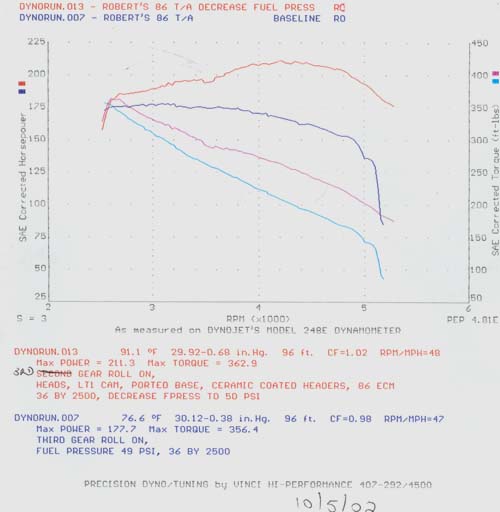

dymno with 882 heads on engine. as you can see they don't go past 3500 rpm.

now with lt1 cam and l98 iron heads
