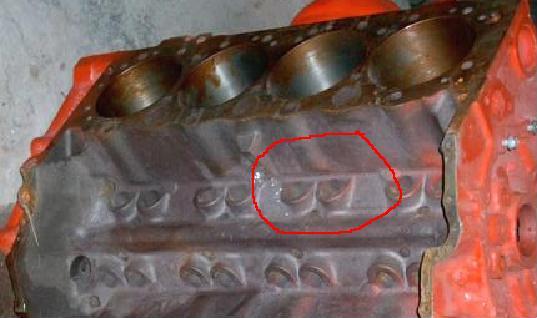

The tops of the lifter bores isn't the problem, the area on the wall of the lifter valley is.
Here's a couple of pics I have that should expain it...
This pic is of a block that has NOT been machined for clearance
Attached Thumbnails roller cam in non roller block-non-roller-lifter-valley

Here's one from GM that HAS been clearanced.
Also notice the lack of bungs for the retainer "spider" to bolt to on the block aren't there. Good luck getting the "spider" to stay somewhere.
One more thing...
You say you have a block that was cast in '92, but is a 2 pc. rear main seal???
Either it's a replacement engine (AKA "GoodWrench" block), or it has an adapter to fit a 2 pc crank into a 1 pc block.
and, just in case you had the thought that I had at one point - no, you can't drill and tap that central 'spine' there - it's an oil galley.

Twice the price. But anway, like Blueyes said, when I went out to size up the situation, I realized that it was an oil galley. But couldn't you still drill and tap it and either put in a stud or even a bolt with some thread sealer?

That oil passage is the one that carries pressurized oil to the main bearings, rod bearings, and cam bearings. Do you want to risk a leak there? I didn't think you would, I wouldn't either.
If the block doesn't have the provisions for the factory's goofy roller "system", it will probably cost you more in machine work to "retrofit" it, than it would to either just get the right block for it in the first place, or to simply use the sensible original roller design. Don't forget, you'll have to have it machined for that retainer plate at the front of the cam, too.
