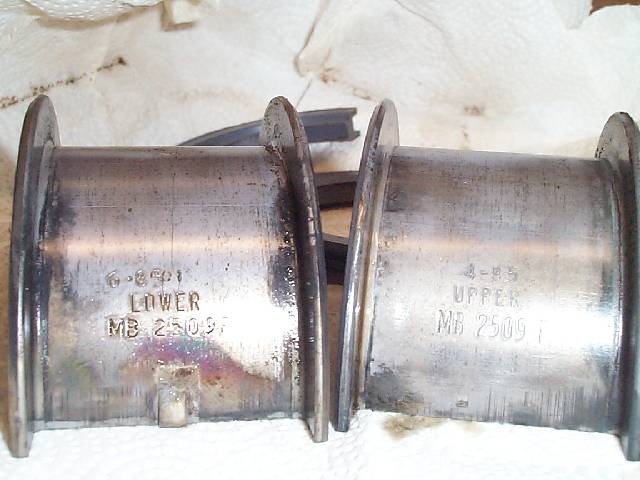

Is it possible to install the main bearing upside down/backwards??
Was just flipping through my chevy overhaul book and noticed the sectino showing bearing failure on new motors that had the main bearing installed upside down blocking the oil hole. I just put my new bottom end together and I really did not pay attention to those holes.............isn't it fool proof??? i thought their were tabs on the bearing that only allowed you to install them a certain way?? **** now I'm worried. They were clevitte 77 bearing.
Old May 26, 2003 | 10:05 PM
Vader's Avatar
Posts: 19,679
Likes: 316
Yes, it matters. Oil delivery to the bearing is dependent in the hole position.
That's one of the things I like about the Clevite 77/Gs - they're marked rather clearly:
Attached Thumbnails Is it possible to install the main bearing upside down/backwards??-mainshells.jpg

and the obvious hole in one of the bearings:

So the top one won't have a hole?? I'm going to remove just the caps so I don't have to tear down the motor again then.

the one for the cap will not have a hole. the one for the block will. as you can also see in the pic, the other bearing have a groove in them. those also go in the block. the flat ones go in the caps.
