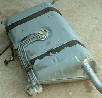

Got the tank out...
Well, I finally got around to pulling the gas tank today. It took my me and my dad about four to five hours, but we did it. Most of the time was spent just unbolting stuff--and since we're taking this opportunity to fix some other things while we're at it (i.e. squeaking shocks and bad rear brakes), we took more out than we really needed to.
I ended up draining the tank by forcing/hardwiring the fuel pump AFTER I had the tank out because I went through hell trying to figure out how to do it beforehand. Turned out, I was shorting I was using a bad wire to make connections (yes, I actually managed to use a "broken wire" that didn't look broken) . About the only nonstandard thing I had to do was cut the muffler off (since mine was welded in at the cat). I cut it off about 3 inches from the muffler but, looking back, I wish I had cut it near the cat--would have made pulling the tank easier.
I also figured out where the tank was actually leaking: it was leaking from the region where the filler neck connects to the tank (which was originally what I had thought). You can see now how deceptive that first picture was--I could have sworn that the leak was comming from ABOVE the tank when I saw that. I suppose the leaking fuel was just absorbed upward by the dirt.
To fix the tank, I had my radiator repair man (who was cool enough to open up his shop on Saturday just for me) just solder around the neck.
Now I just have to put it all back in...
<i>Just out of curiousity...</i> Was this exactly the problem that GM responded to with a recall (leaking from where the filler neck meets the tank)?
Attached Thumbnails Looks like I'll be dropping the gas tank; a few questions...-before-06142003.gif
