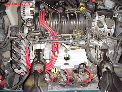

If you have plenty of patience, than build your own with MSD 8.5 bulk wire (Part #PN 34019)
You'll also need to choose the proper boots.
It won't save you a whole lot of money, but they look perfect if done right.
You might need 'There' wire crimping tool if you don't have a vise.
I did mine on a vise and they turned out absolutely gorgeous.
I tested each one before installation, and after a couple weeks of running them. (50 ohms per foot!!!)
I have so much patience I also did my '00 Impala.
Ron
