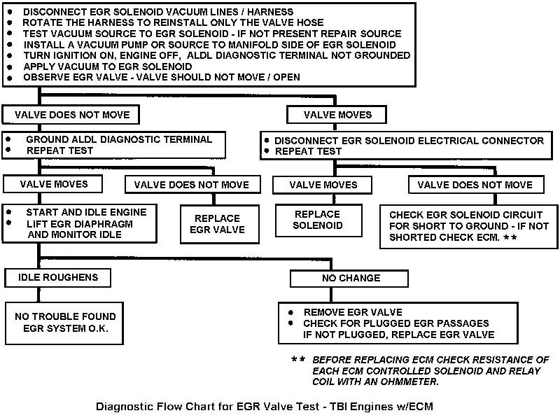

I just ran the codes on my car and came up with a Code 12, 23, and 32. I have a 305 TBI so how do I figure out wich of the codes is the problem and Vader thanks for the help I would still be trying to figure out how to do this.

If you downloaded the *.PDF file with the error code definitions, you should have a good idea of the problems. Some of the codes have different definitions for different engines, but I believe most of those are listed.
The 23 on your TBI is for a low temperature fault of the MAT (Intake or Manifold Air Temperature) sensor. That is usually caused by an open circuit between the sensor and ECM or a failed sensor. Make sure the ECM ground wires are connected at the engine and the sensor is connected. If the wiring is intact, remove the connector and measure its resistance at a known temperature. Compare it to the chart:
If the resistance is not within a reasonable range, replace the sensor.
Your 32 is for a fault with the EGR. Check the connections at the EGR vacuum solenoid, the engine grounds, and vacuum lines to the EGR. If there is nothing obviously wrong with the device connections, follow this flow chart for error diagnosis:

Thanks for all the help guys you have saved me a lot of time and money. Today my dad and I are going to Check the EGR and the MAT to se if I can get that stupid light to go off. Thanks for all of you help and thatnks for the pictures Vader you've been a lot of help. Thanks
