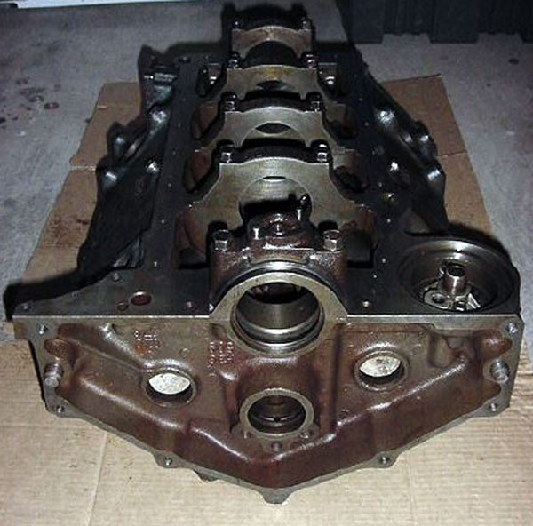

I saw some pics a while back in here of a chevy 350 2 bolt main block and the caps looked different than I have ever seen, it looked like a better design, instead of the caps being pretty much square looking, the caps were angled outward where they attach to the block like this /---\, this was not a splayed 4 bolt conversion but it just had 2 bolts, I was thinking it was just a stock block, but it looked stronger than a regular 2 bolt.

All the front caps are like that. Are you sure the photo wasn't deceiving you? They may have been aftermarket caps, too, but I can't fathom installing two-bolt aftermarket caps.

No, the center caps were like that, that's why I noticed it so much, after some more thought maybe it was a 2 bolt 400 block, with the bigger main journals GM may have spread the caps out at the base.

Sorry but no, not like that, I know what splayed caps look like, this was a cast 2 bolt cap, I have searched for the pic but can't find it so far, I'll keep looking and post it if I find it.

Ok, mystery solved I think, I just found a pic of a 400 block on E-Bay, it has the mains like I was discribing, here's a pic

The 400 block has straight bolts just like a 350 it's just the shape of the caps that make it look like a splayed bolt pattern.

Yeah, I knew the bolts were straight, that's easy to tell just looking at it.
