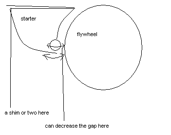

gmsmallblockguy's Avatar
Joined: Jul 2003
Posts: 81
Originally posted by icebird_1981
it comes out and lines up with it fine> but the teeth on the starter are just not long enough to go in the flex plate teeth, just barley touches it.
This is a bad quick drawing but take a quick look and you'll see how you can correct this with shims.

thanks for the idea, were would i be with out this site lol. anyway i am going there in like 30 min to see whats up with them trying the new starter. i am going to tell them to try shimming just on hole.

If they're putting starters on it that are part # 3510, have them put a 4347 on it instead. This starter will require 2 different length starter bolts, one long and one short, instead of the 3510's 2 identical medium-length bolts.
Incidentally, starters MUST be installed with starter bolts, which are special, they have a sort of knurled and enlarged shank just below the threads that acts as a "dowel pin" to positively locate the starter on the block at the correct spot. Regular bolts WILL NOT work right.
Shimming the outer hole works, but is not the best thing to do, since it keeps the starter from being in full contact with the block. The bolts almost always eventually loosen. However, if they can do that and force it to work, then you know for sure that your block has The Problem, and that you therefore need to go get the right starter and bolts.
I don't know where you got your block from; but if it seemed to be in good shape, somebody had had it in their car running, and you bought it for seemingly a real good deal and there was nothing really wrong with it as far as rings or bearings or needing bored or whatever, then it was probably because the previous owner was tired of futzing around trying to overcome The Problem. You'd be amazed how commonly this happens.
