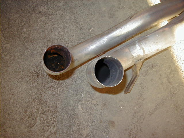

The L69 exhaust, for what it is, isn't that bad. Below notice the difference between the LG4 and L69 y-pipe--don't get me wrong, I'm not arguing against headers. With this exhaust, however, L69s were capable of, I think, 138 mph top end and were capable of whacking some 350's.

The stock intermediate pipe is larger than the after market catback that I was previously using. You can see the difference, perhaps better, in the pic above to the right.

James' pictures of exhaust show one of the main differences between the L69 and LG4. In addition, the cam was different; the carb calibration was different; the L69 cars came with 3.73 gears, instead of the 2.73 and 3.23 gears so common in LG4 cars; and flat-top pistons, which ended up in the LG4 in later years too.
