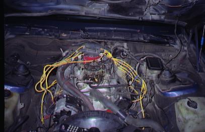

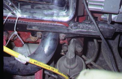

i have seen this question asked alot around here: "how do you run accessory on the double hump heads that dont have accessory bolt holes?"
well, here are some pics of how i did it. i have had the engine setup like this for more than a year. it ahs had 40+ trips down the 1/4 (best so far is 13.87, with 3.23s and an open diff, and 2.3 or geatre 60fts. i now have 4.11s and posi, but no times yet). this has never thrown a belt yet.
now, i am by no means recommmending this setup, as we all know there are much better heads than old double humps and having heads with accessory bolt holes is easier and better. i just thought i would post what has worked for me. please feel free to comment, criticize, or call me a complete moron.
thanks
Attached Thumbnails pics of accessory brackets for 461 heads-alternator1.jpg
Old Sep 28, 2003 | 04:37 PM
darbleinad's Avatar
Posts: 1,761
From: Ailsa Craig, Ontario, Canada
Car: 84 Trans Am
Attached Thumbnails pics of accessory brackets for 461 heads-alternator2.jpg

Old Sep 28, 2003 | 04:39 PM
darbleinad's Avatar
Posts: 1,761
Car: 84 Trans Am
Attached Thumbnails pics of accessory brackets for 461 heads-powersteering1.jpg
