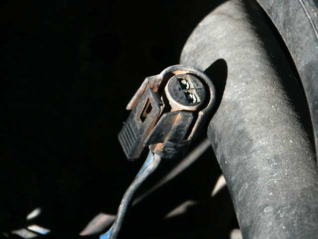

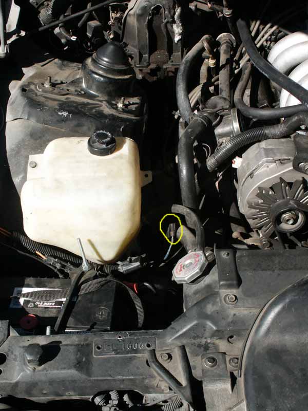

hm... well, I connected the 2 prongs that I thought was the sensor, but I guess that wasn't it. fan still came on.
What does it look like? did it look like the male end of an electrical outlet cord? (minus the center round prong) and with a rubber "boot" around it?
Well, what ever that was (it was plugged into the silver canister thing before I took that out), I undid the connection, for fear it might be something thats not supposed to be connected

There are a few electrical harnesses associated with the A/C system. One is a large connector at the silver Reservoir which is not the one in question, the one we speak of is a smaller connector that is halfway between the silver canister and the battery. If you removed the A/C lines that go between the canister and the condenser you may recall the sensor built into one of the lines. That is the sensor that needs to be jumped and remember about the delay if you jump it when the engine is running.
If you can post a pic I might be able to point it out.
tj
tj

hm... I think I know which one your talking about, I'll post a picture just to make sure before I blow something up

is this is? a close up. I believe this connector went into the metal tube going from the canister (bottom maybe?) to the condenser

im not sure about the connector, but from the first pic you posted, i should tell ya somthing..

does anyone know if this is the sensor? I don't want to blow anything up by just guessing and have it be the wrong one!

yep, that was it! my fans dont come on when I start the car now!
