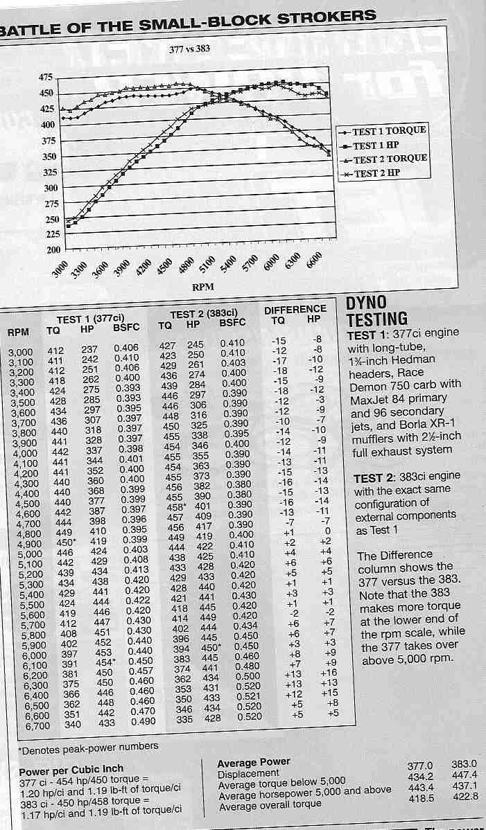

For discussion purposes:
Let's dismiss the 400+cubic inches for now...
Say you overbore the 4.125" block .060 to get 4.185" and use the 3.48" stroke crank. That makes a 383. Now, let's compare the (2) 383 versions. What airflow potential, if any, would the bigger bore engine have over the smaller bore 383??? Also, would the shorter stroke allow it to "rev" quicker under the same load conditions??? What high rev potential would the shorter stroke engine have ovr the longer stroke??? Both have the same cubic inches...so IS there any REAL difference???
I can't answer based on my experience or hands on knowledge...
I think the only things to consider are less shrouding of the valves, thus potentially better airflow. I'm not sure which would have the "lighter" rotating assembly, "all things being equal" (if there is such a thing). I know each can be built to turn high rpms...but is one truely at an advantage over the other in this area?

if you build a 383 and a 377 and invest the same money into each that a 377 will be much better
On the other hand, a 400 will be better than either of those. It has the bore of the one and the stroke of the other. Think of a 377 as a 1/8" overbored 350; in reality, that's all it is.
You quote big blocks.... look at the 396. That's very similar in many ways to a 350; small bore, short stroke. The 427 is much like the 427; larger bore, same stroke. The 454 is much like the 400; large bore, and also a longer stroke.
Now, which one of those was your friend running 12 flat with again? Do you honestly think he would go faster with a 427 than he is with the 454? Then would it make sense that you would go faster with the 372 than you would with a 400?
The reason people build 383s is that they don't have a 400 block; or even if they do or can get one, it's not roller cam and doesn't have the 1-piece rear main seal. It's not because the 383 is a better motor than a 400. Same with the 372 (or 377, in a .030" overbore); it's also not a better motor than a 400. The only reason I can see for running that is if you're in a 6.1 or 6.2 liter limit class. If you're not doing that, then it's not the combo for you.

Or if you have a 400 with a wiped-out crank, and have a steel 350 crank sitting around. Then it might make sense to build the 377.
I'm not sure I'll agree with the 377 (as in 400 block/350 crank) being better for the same money spent on a 383 (as in 350 block/400 crank). 383's are getting about as cheap to build as 350s these days because of popularity. 377s, on the other hand, require relatively rare. So, you can spend more money on 383 go-fast stuff compared to the 377 which will be more expensive just to get it together.
I don't know if the magazine article that's being mentioned is a recent one, but the last one I saw comparing the two was about 18 months ago. The 377 made more peak power, but it didn't pass the 383 until over 6000 RPMs. And, neither engine was "optimized" cam-wise.

I had a 350 in my car until this past August, when I dropped in a 383 shortblock. Heads, cam, valvetrain, headers & exhaust were all resused from the 350. The only difference is a .5 increase in compression, a MSD crank trigger setup, & a retune of the fuel & spark curves. Results:
350 best 12.895 @ 106.21
383 best 12.031 @ 113.11

The 33 cube increase did not net you another 7MPH in the quarter with the same engine parts... that's laughable. It sounds like your gain was more from the tune.
BTW - I've got your burnout video saved... very nice
I would agree some of the gain was possibly from the tune. However, I could not use the 350 tune on the 383 & expect it to run properly, could I? Point is if anyone here thinks a longer stroke won't produce more torque earlier in the rpm band, they need go back to high school physics class.
In a properly built motor with all the Is dotted and all the Ts crossed a 1hp per cube increase will be realized, often it is more, or equal to whatever the original HP to Cube ratio was. With the additional .5 point in compression you could figure for a an additional ~2% increase in power. All other variables held equal.
Also for some reason people seem the think of 383s as a common setup these days and forget the true power they are capable of.
A 383 Vs. 350 is the same arguement as a 350 Vs. 305. Uhhhhhh hello!!
Go for cubes, its a no brainer.

i'd like to say thank you to all who support the 377, and i'd like to add a couple of things...
in an N/A situation i would agree that more cubes = more power, for the most part at least, but that T-78 turbo i bought (i never actually got it though, long story, so im thinking twin T-49 - T-52's) anyways the T-78 came off of a 3.0 liter supra making 784 RWHP, which is already more than i need... not more than i want but more than i need, also i have an article on some famous racer i forget the name who has a 283 twin turbo in a grand national running low 7's, his is a race only car but still weighed 2900 lbs, im not trying to run 7's but my point is in a turbo motor i can achieve more power than i'll ever need in a 377, i was actually considering a 352 (400 block 327 crank) aswell, and if you still think im an idiot and im doing things the hard way i do have my reasons..... the short stroke make high RPMs (over 8k) much easier on the motor, so i dont have to rebuild every season, the long rods help with quench and some stuff i dont really understand yet, but in short it helps to reduce detonation which is a concern considering the high boost levels. and lastly i need the high rpm powerband because the turbo's wont spool till 3500+ rpms... and so in order to have a decent powerband i need to turn it to 8000-8500 rpms maybe more who knows, and while you can turn a 400/414/427 etc this high how long can it take it??? a shorter stroke motor can definately take it for a lot longer period of time
if im wrong then i guess i'll learn my lesson, but from what i've seen from other people's projects just about any small block with good sized twin turbos will make the power im seeking and so i am positive i wont fail

Everyone dig out your Chevy Hi-performance, Oct 2000. They did a cool 383 vs. 377 shootout. They made every attempt to make the two motors exactly the same. They had the same heads, carb, cam, intake, compression, rod length, rocker arms, same everything.
The difference is the 377 is the 400 based motor with 4.155/3.48
and the 383 is the typical 4.030/3.75
There final conclusion: "As you can see both engines are very close in power. It appears the 383 would make a better street engine, while the 377 would make a good road-race motor if you were willing to wind the engine a little tighter. With better cylinder heads(they used Trick Flows), the 377 might end up with a more significant increase in horsepower, but both engines are winners in our book."
