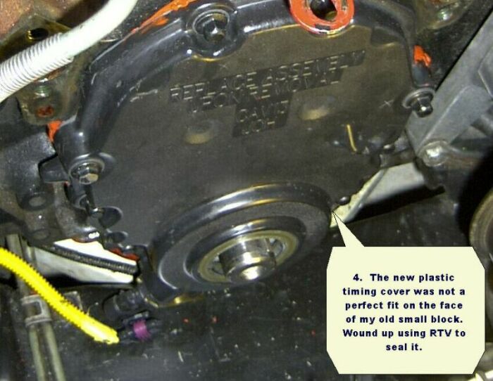

The Vortec parts can be made to fit, and they are excellent pieces for hotrodding a V8, but the physical interface with that 730 ECM may be pretty complicated.
If you plan to run the $8D mask for the 730 ECM, you mainly have the problem of where to get a spark signal during cranking - $8D has no provision for this, it's handled in the HEI module.
There is also a general size limitatiion on the timing chain you can fit behind the Vortec crank wheel. See the pix below:
Unless you can write your own code patch for the $8D ECM, you are probably stuck with the original-style distrib for a start-up pulse. The $8D mask has no use for a cam signal anyway.
If you get beyond that, the Vortec ignition module & coil are excellent pieces for a modified engine - they are designed to throw more spark energy than the stock HEI parts (as I understand them). Good luck.

Also
Attached Thumbnails Question about 96-99 Vortec truck style distibutors.-3timingsetas.jpg

Last:
Attached Thumbnails Question about 96-99 Vortec truck style distibutors.-4timingcoveras.jpg
