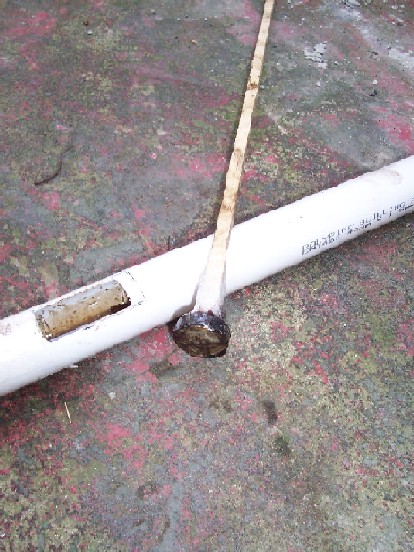

A32Camaro - thanks for the tip, and others with the PVC tube idea, that's just what I did, with one small modification. I attached a magnet (from a 10w tweeter speaker!) to a stick so I could insert the tube and leave it in, just in case any lifters decided to fall, the tube would stop them. Worked a dream :lala: (see attached pic).
Many many thanks for all the help guys, just shows how a bit of collective experience and head-scratching helps.
