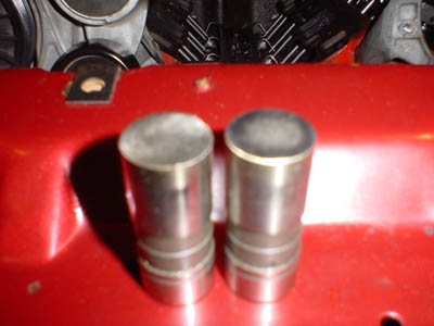

what ever you do with a 350 block... dont let it do this to you...
Those two lines should be parallel

wtf?? did the cam get bent or are the lobes worm unevenly??? i dont see what im supposed to be seeing...heh

look at the angle on the last lobe... its supose to be straight across... there were 4 lobes like that... and 4 lifters that would not come out of the holes... the lifters instead of being flat on the bottom... were majorly dished on the bottom... very fun to pull outta the block.... the one on the left is dished and the one on the right is flat like it should be... little scratched but flat.
