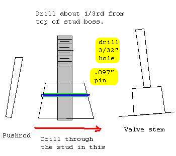

The roll pins I used to pin my heads and all the others are .095" thick.
The drill bit used is .092".
Has stood to numberous 7000rpm+ blasts and .550" lift.
I would not use a pin any thicker than .125" (1/8")
That would weaken the stud boss.

BTW F-BIRD'88..... do you need a special long drill bit for this? And does it have to be perfectly perpendicular to the top of the stud boss, or can it be at somewhat of an angle say if your drill wont fit in there right?
Old Dec 29, 2003 | 01:32 PM
F-BIRD'88's Avatar
Joined: Sep 2001
Posts: 6,111
Likes: 53
From: Ontario, Canada
Car: 1988 Firebird S/E
Engine: 406Ci Vortec SBC
No and No. Eyeball straight is good enough.
There is nothing really technical in doing this.
The trick is to use moderate pressure and speed on the drill and sharpen the bits as needed.

Where do you buy your roll pins at? Do you know where I can order them online? The closest place to where I live that carries them is Harbor Freight, and its a long drive to the nearest one. As far as using a .092 drill bit and .095 roll pins, what sizes are those exactly? The closest drill bit I have seen to that size is 3/32. But that comes out to .9375.
I've been busy porting my heads, and so I have put pinning the studs off to one side for the moment. If I get a chance, I'll post pics of my progress with the heads this weekend.
Old Jan 3, 2004 | 03:46 AM
F-BIRD'88's Avatar
Joined: Sep 2001
Posts: 6,111
Likes: 53
Was wondering why you were having such a problem.
Well I went back and measured the left over roll pins and drill bits I used and the bits are indeed 3/32"
The roll pins are not exactly perfectly round. Range from .097" to .104" as you roll it in the dial caliper.
Most well stocked hardware stores have 'em.
I got mine at the lil mom and pop hardware store at the
top of my street.
Sorry for the inaccurate size info. Hope this helps.
Any simularly sized roll pin and drill bit size that would allow a slight press fit to compress the roll pin will do I guess.
This is what worked well for me.

The pinning method is good for mild applications/cams. If you have a beefy cam and very high lift, it's not recommended.
The BEST way is to pull the head and have the bosses machined down for TRUE screw in studs.
How much lift would it be able to handle.. I'm looking at .510"... will the pinned studs handle that without pulling out?

Pinning would probably work for .510 lift, but if it were me, I'd spend a little more money and get screw-ins.

i would just say screw it and get screw in studs anyway. just my .02
