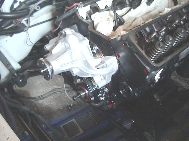

How hard is it to remove heads? Im already down to them but I wasnt planning on taking them off.. They dont leak and never have but one I remove them will they start leaking? Whats under them that I have to worry about? when and if I take them off will a bunch of part coming falling out?..
I know, stupid question but hey!....

i wont go into WHY.. just the how.
removal:
take off the exhaust manifold and the intake.. loosen the rockers, and remove the pushrods, you dont have to take the rocker arms off, just loosen them enough to get at the pushrod. im assuming the coolent is drained...
unbolt the heads...
lift them off... if its a PITA to come loose, you can pry a lil on a non sealing surface.. like under the intake ports.
install:
clean the block surface and head mating surface...
lay your head gasket down on teh block.. there are dowel pins on the block, so it will stay put.
set the head down in place.
put your sealent on the bolts and snug them all hand tight... i usually use a speed wrench if theres room.. quick and easy, but you arnt trying to tighten em.. just start em.
now looking into your book (pretty much all the repair books have it) follow the TQ sequance and tighten the bolts in order....... first time, tighten to 1/3 of the total amount... do it a 2nd time in order to 2/3rds the amount... and the third time, do it to the full amount. the amount is what the BOLT maker says... so if you're running ARP bolts, do what ARP says.. if you're running GM bolts, do what the GM service manual says, ect...
head bolts are torque to yeld.. while some backyard techs would argue the issue, its smart to use NEW bolts.
thats the how.
not that hard at all... just bolt it on.
btw this is the first real mod i did in highschool to my car... i needed new valve seals and pulled the heads... seems kinda scary at first.. but eventually you learn.. theres nothing to it but to do it.. its just a block of metal carefully bolted onto another block of metal.. no magic envolved.. jsut be careful to make sure they seal right
removal:
unbolt the heads...
install:
thats the how.

The reason Im thinking about taking them off is because Ive been in the process of putting in an LT1 cam i and Im waiting on my headers to get back from coating. Ive already starting grinding on my intake,"which I have no clue what to grind" so I was thinking I might as well go the whole way and port the heads too.
Once again I wouldnt know what to port on the heads. I looked at them while on the motor and it looks like there is alot to port out of a head.
Im probably going to get in touch with Dan Burke and get him the port the stuff...I would rather pay someone to port it for me than me screw them all up...
know what I mean?
If I got the LT1 cam, ported plenum, ported intake, ported heads, headers, I should get me some good HP...right?
