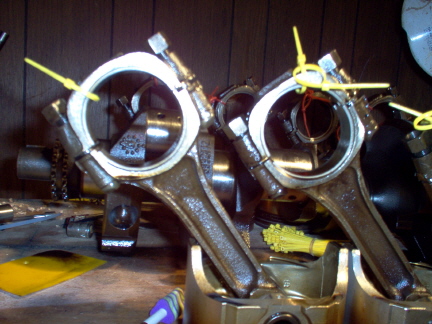

anyone know what type of rods these are?
are these i beam or standard Cast

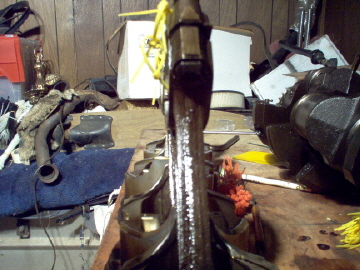

side view

They appear to be standard stock forged (cast blank) steel rods, just like these:
However, appearances can be deceiving. Are there any identify marks?

They look to be factory rods, and they are also I beams.

there are no cast rods fors a SBC, maybe cast blanks but the end result is a forged rod. stock rods are i beam. can't measure pistons with a caliper, at least not where it matters. pistons are tapered and sometimes out of round. to measure a piston use a mic on the same palne as the wrist pin at rotated 90* from the wrist pin. not sure on the exact sizes, you'd have to check the spec sheet for your pistons, but stock would be near 4" and +.030 would be near 4.030. if your running a power adder you'd want forged everything. if you're planning an engine either plan it NA or as a power adder now. you can't optimize parts for both.

A connecting rod has a very hard life. It really needs to be a strong piece. In a street engine like what you are planning, cast pistons and cranks are just fine. Get good reconditioned rods. You don't want one coming apart.
BTW, a forged steel part in not necessarily heavier than a cast iron part. It all depends on how it is marketed. My forged steel stroker crank weighs 5 lbs less than a standard iron crank.
