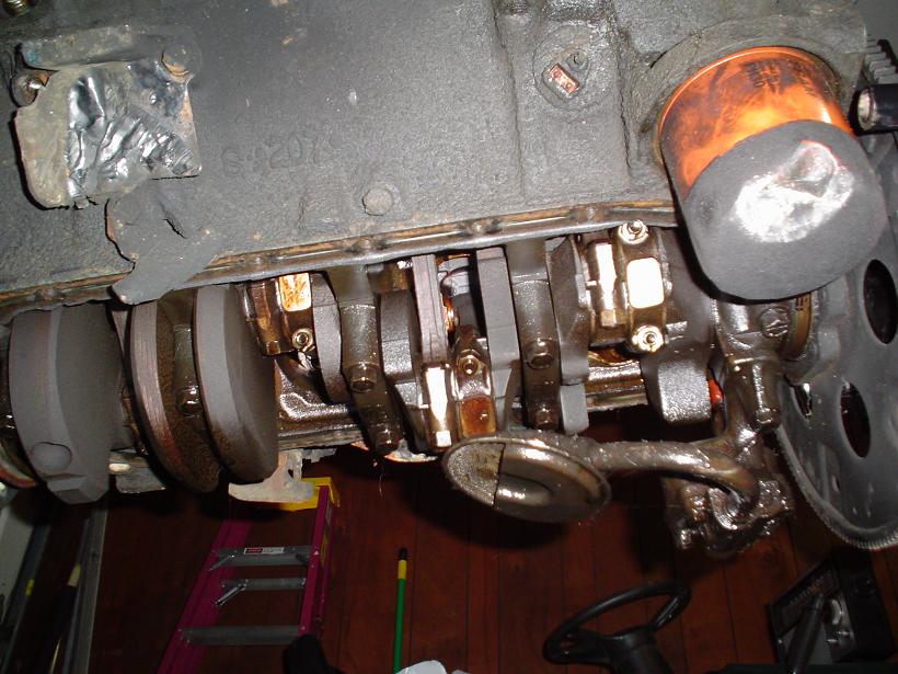

here is one side of it.

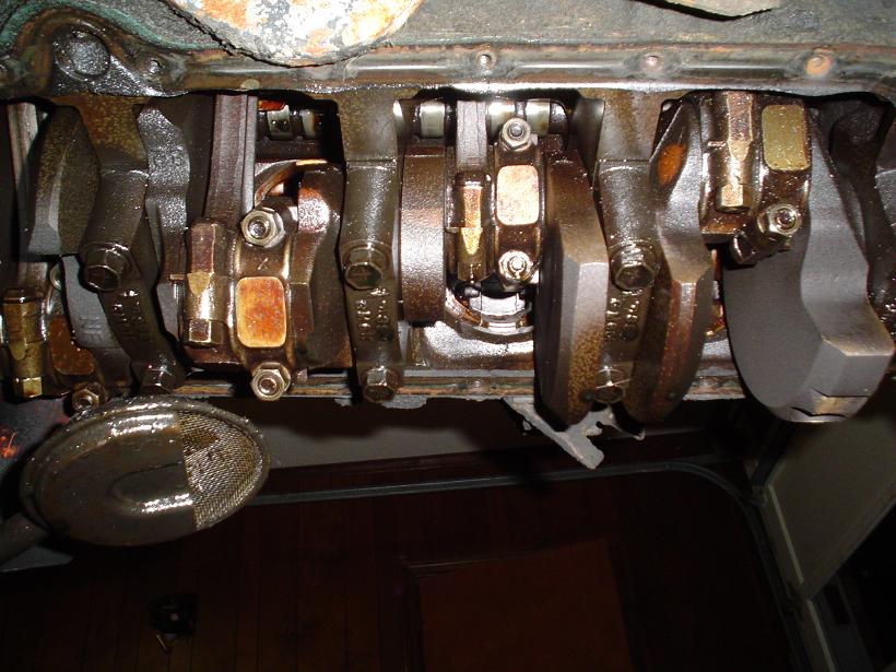

sorry I had to do this but I can't figure out the [img] [/img] deal, so I had to resort to this.

only way to tell is by pulling the oil pan and look at the main caps.. there are five rows of em, the ones of either end will have 2 bolts and the center 3 will have 4 bolts across.. really easy to tell just count.. cant really tell from that pic but it looks like like theres 4 bolts on those caps.. kinda hard to see from the side but it appears to be..

yup thats a 2-bolt

That's a 2 bolt block.

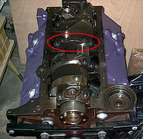

Here's what a factory 4 bolt main looks like.

ok well it's settled it's a 2 bolt main... So why do people perfer the 4 bolt over the 2 bolt when at the year my car was built it had the same amount of hp and torque???

2 bolt main
that is a 2 bolt main motor typical of late70 to early 80 vette and camaro engines, you can tell that it is , for that time period, a hi performance 350 because of the X rods (see the X on the connecting rod cap) that bottom end as long as its tight should be good for 6000 rpm..... im not saying in its state now it will turn that but im saying that set up (2 bolt mains x rods cast crank)its good up to 6000 rpm. same motor in my old z28.... dont let anyone tell you 2 bolts are no good, there perfectly fine unless your towing a 10000 lbs trailer or running 7000 rpm for long periods..... good luck with it!

k after lookin at the second pic i'd havta say its a 2 bolt.. an you could always get em splayed and have 4 bolt offset... stronger then a factory 4 bolt becasue its triangulated instead of linear.. kind of an unnessicary expensive to unless you plan to run a lot of spray or a power adder or somethin... not really nessicary at all on a street car.. my mains are splayed but only because i got the block with the machine work already done.. if it wasnt already done i wouldn't have bothered since its not really nessicary for what i did with it.. but its nice to know that its already there if i plan to go a little overboard with it in the future
