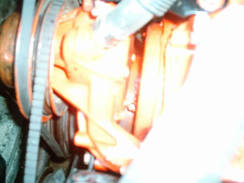

okay, well i couldnt get a timing light so i was just turning the distributor with my hand and timing it by ear. not much luck.
it was running really hot, and wanting to idle high. Im not sure if the carb is working right. When i pulled back on the throttle mechanism (ive circled in the picture) it slows down the engine to more of a normal idle. It doesnt seem to rest back all the way. (maybe the spring is to weak, but i had no problems with it before. is there a way to adjust this or set this?
ive never adjusted the carb before so im not sure what i should do. I dont wanna screw it up so i figured id ask here.
(sorry about the blurryness of the pic)

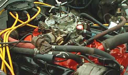

here are some more pics of my carb the way its set up now. I wasnt sure if i put everything together right. i shoulda taken more pics before i took it apart. i had to block some vacume lines and stuff.
anyway, if you see anything thats not the way it should be, please tell me.

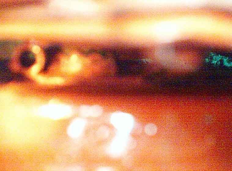

one of the valves (EGR?) that comes out of the thermostat housing is broken. all the conectors busted off. so i sealed it. what kind of effect would that have?

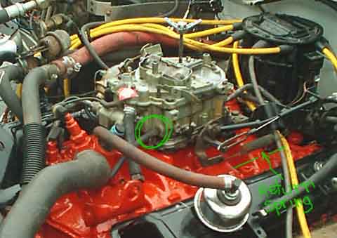

sorry for all the pictures. i hope they dont load to slowly.
anyway, does anyone know what this hose is for? its source is the throttle thingy shown behind it. I dont know what its for or where its supposed to connect to...

Manchester, it almost looks like you have a bolt stuck in the end of the float bowl vent line. Is this so? You want to have that open, it is not a vacuum line, its a breather line/vent for the float bowl. You can leave the hose on there, but take that bolt out.

For the last pic you posted, that is the cruise control. If that is the long vacuum hose from the cruise control unit, it runs up along the steering and around the back of the engine bay, and comes up and connects to the fitting in the intake manifold, IIRC. There might be another branch-off that it connects too that you forgot to hook it up to, and you might have a big fat vacuum leak till you get it hooked up there. Good luck!
edit: That manifold fitting should be right behind the carb.

That last pic you circuled......isn't that the vacuum line that supposed to go to the charcaol canister???
I'd double check that one if I were you....along with all the other hoses. It shouldn't smoke like that.

I figured if you didnt have it hooked up that you didnt have a charc. canister. Just leave it opened. Thats what I do and it's never leaked a drop of gas. If you drive down dusty roads all the time, I guess you could put a filter on it, but I woudlnt worry about it a whole lot.

I was JUST going through a search for something on here and came across this pic, might help you out dunno, but here it is.
Also, in your first pic, it doesnt look like it but do you have a return spring on there, on the bottom of the linkage lever?? I dont see one. You can get one from autozone for couple bucks if not, and I would get one on there or your throttle will stick open on ya, and you'll have problems. Just didnt know if you were relying on the small spring around the throttle shaft on the opposite side to return to closed or if you actually have a return spring on there, its hard to tell.

hmmm, so judging by that pic, i think i had the vacume advance wrong. so acording to that, the line i have circled here is the one that goes to the vac advance on the distributer? is this right?
yup and i got the return spring there. i can understand how its hard to see, the picture quality isnt the greatest...
