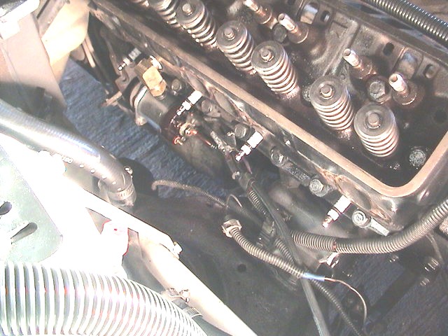

and heres a picture of my starter and the solenoid that I put on it..
dont mind that peice of aluminum heat tape that I had wrapped around the wires....I thook that off...what if there was a piece still left on it, would that make a difference?

Originally posted by Morley
Ooooo, one of the end cap bolts, you need that on there or the cap will try to pop off when cranking, one bolt isn't enough to hold the whole thing together.
could that be my problem? it cranks but like I said it strains really bad to crank...and so forth ..posted above about my crnaking problems

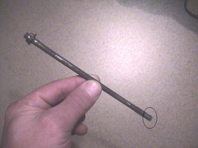

here is the bolt, the circle is where it is stripped...
oh yeah and a picture of my hand too.....
all that bolt does is hold the cap on...it doesnt have naything to do with cranking the car? or does it? I seriuosly think that is not my problem.
I dont want to get off ...what else should I look for.....when I bolted the wires back on to the solenoid I made sure they were the same...
I would almost bet on it, you may have trashed the bearings/bushings in it by now if the cap was trying to come off.
how many bolts to remove the starter? 2?
SOB!...I dont want to have to remove that thing!

With that bolt missing the case is probably tweaking pretty good. Try finding a replacement and see if the starter will still function ok. Otherwise, a new starter is in order.

Originally posted by Wishmaster's87IROC
Isnt that cap just a cover?
AFAIK, that cap supports the rear of the armature in the starter. Without it secured, itll scoot around under load.

The starter has no chance of working right without that bolt in it.
The "cap" is more than a cover. It is the support for the bearing that supports the end of the starter motor shaft.
EIther repair the stripped threads with an insert and re-install the bolt, or replace the starter.

I'd vote for the latter of RB's suggestions. If you've cranked the engine several times with that bolt missing, the damage os probably already done to the field, armature, and commutator/brush holders. I'd be shopping for a replacement starter.

Ok guys,
I got the starter off, is there anyway I can test it. I'll post a pic here ina few...for some reason the starter feels light, not like the 23lbs that I have read unless it just seems light to me..I'll put it on my scale and see what the weight is...
Anyways, if I buy a new starter and then it does the same thing, then what? I made sure the ground was ok from the battery to the block. when I post a pic I show what wires were where on the solenoid......
BRB!
BRB!

ok heres the picture....on the starter cap...it says DELCO REMY
#1998580 70 23
what starter did I have? anyway to pull the part# up anywhere?
The cap that is held by those to bolts dont look like they hold anything together but what do I know...
never mind, I pulled it up on acdelco.com and it says it was for my car back on 87-89
man I hope th new one works....
oh well hope it works cause I just ordered the 1995 Z28 starter and going to pick it up in the morning. Then I'll wait till theres some dummy in there and return my 87 starter...hope they dont catch it...
#1998580 70 23

Teh way you have the wiring is correct. The positive lead/fuseable links hook to the large terminal and the solenoid wire hooks to teh terminal closest to the block. The other terminal is to supply constant 12 volts for accesories. Nothing connected to that one.

I seriously doubt that its the starter...it seems fine to me....but if you guys say so...I guess I need a new starter anyways..but I could have spent that money elsewhere...
my luck would be that its was because of the wiring on the solenoid but I checked that.....when I put the solenoid on there was really no way you could put it on wrong...I wasted my money on that cause I didnt save the old one thinking everything would be ok...and now I have to return the new solenoid with the old starter and get a new one with the new starter...only 18.00 I think but its still money.
and I checked the wires behind the passenger head and they didnt look to be frayed in anyway....but I guess we;'ll find out tomorrow...

Taking one of those bolts out is like taking one of your motor mount bolts out. I suspect youll find that your new starter will work much better then the present one with a bolt missing.
