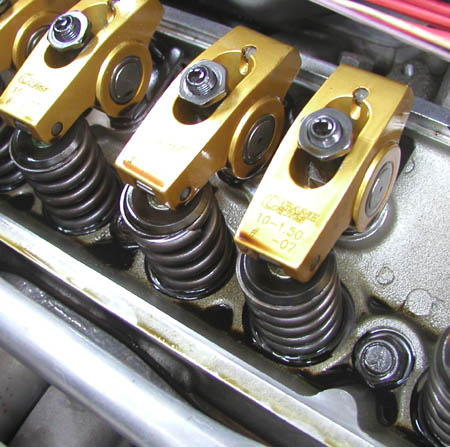

Just tracked down the problem that I was inquiring about in this thread
https://www.thirdgen.org/techbb2/sho...hreadid=222329
The center spring is kinda different from the rest..RIGHT??
The heads, rockers..everything related to the valvetrain has about 5k miles on them.
TFS 23 heads, 1.25in springs, Crane 2032 Compucam.

Yep, same here with the 1.25" TFS springs. There are others that had trouble with those sprinds and posted here and on other boards.
https://www.thirdgen.org/techbb2/sho...ght=tfs+spring
I'd get them outta there ASAP!

Alot of the head mfrs do this to their customers. I don't understand it.
They put some cheap crap for springs on their product, like K-Motion or GM's "Z28" springs or something. Total garbage whatever it is. WHy anybody would go to all the trouble and expense of manufacturing a casting like they do, and then install a bunch of time bombs on them, is one of those mysteries of human behavior that I'll just have to study that species a little longer before I can answer.
Your heads look to me like they're machined for 1.45" springs. Throw all that inferior 1.25" excrement in the trash, and put a set of 1.45" springs on there from one of the cam mfrs (NOT K-Motion or some other low-bid stuff from people who don't make cams), along with the matching retainers and keepers. Comp 986, or the equivalent product from Lunati, Crane, etc.

Just spoke with Charlie at Trick Flow; he explained that the 1.25" springs were not really compatible with Hydraulic Roller Cams.
It would have been nice for them to mention that in their advertisements. If they had I would not have purchased them.
They are sending a set of larger diameter springs for $75.00 or so with all of the retainers and stuff.
If I had it to do over again I would have purchased AFR or Edelbrock. Who cares if they cost more...I'm out $400.00 in rental car and Mechanics fees.....not including my time to put the new stuff on again.
Oh and BTW...Trick Flow is not aware that these springs have been a problem for other people in the past....

The reason the springs are not meant for roller cam use is that they are bull**** crappy springs. Roller cams tend to need springs with more pressure, as they have much wilder ramp ups, and use much heavier lifters. The combination means you need a stronger springs to keep from tossing the lifter off the lobe.
ALWAYS make sure your springs are matched to your cam and valvetrain!
The reason is simple as to why those springs do not work with hydraulic roller camshafts, Hydraulic roller camshafts require a higher spring rate.
When using a small diameter spring, Such a 1.260" diameter, You will need a spring with a rate of at least 400lbs for reliability in performance applications.
Majority of the 1.260" springs do not have a 400lb rate, Most are anywhere from 335-360lbs. Ours are 360lbs.
In the Crane Cams catalog, they list two different 1.255" diameter springs for the 2032 camshaft. the first part number is 99848-16, and is listed as having a 382lb spring rate. The upgrade spring, is 99846-16 (H11 tool steel), And is listed as having a 409lb rate.
Why is a higher spring rate more desirable for a hydraulic roller camshaft? Simple, The rate of lift is higher, Coupled with the weight increase of a roller lifter.
What is "increased rate of lift"? Look at the lobe design of a hydraulic roller camshaft & then look at a hydraulic flat tappet, The hydraulic roller camshaft lobe is visibly more aggressive per degree of duration.
Does using a 1.6 rocker affect this? Yes it does, you are now making the valve lift an additional .032" in basically the same amount of time.
Do I need to change from a single spring to dual because of the ratio change? In some situations, yes...
Valvesprings live & die because of harmonics, If you get a spring into a bad harmonic situation, Guess what happens...
Just because a spring is rated for .520" lift does not mean it will live with your particular camshaft.
Let me use a different example so as to not inadvertently insult anyones intelligence:
Competition Cams # 12-213-3 camshaft, SBC hyd FLAT tappet camshaft.
292*/292*Avd Dur, 244*/244*@.050"Dur, .501"/.501" lift, 110* LSA, 106* ICL.
Does it mean that you can use this camshaft (since it only has .501" lift...)with our 1.260" spring? Absolutely not, Competition Cams recommends that you use their 986-16, 1.430" dual spring (132lbs seat psi) with that camshaft. It's all about rate of lift people...
Maximum lift capabilities have their place when picking out a camshaft, But it is not the only factor in determining the appropriate valvespring.
You cannot reasonably expect one valvespring to cover every single camshaft design out there, It is just not gonna happen...
At any rate, If anybody would like to email me directly I am at akakiou@trickflow.com -OR- you can call me @ 330-630-1555 Ask for Artie @ Ext 6324. I am in the office from 9am-5pm Mon-Fri....

Actually I just reread what 67camaro wrote and he's right...never mind all the stuff I wrote...it's pretty much all my silly own fault...................................................................................................................................NOT!!!!!

67 camaro, thanks for stating the obvious
:hail:
I am so glad you cleared this up for us! Where were you back in '98 when I bought the TFS G1 heads? You could have schooled the cylinder head builder in setting up my heads and saved me alot of $$$$?..........................Not so much!
1. Cam determines valve springs needed.
2. Valve springs determine cam profile that can be used.

Artie Wrote:
So the 1.46" springs that Charlie at Trick Flow is sending me are going to work right? They're only rated to 360# but are larger diameter....
