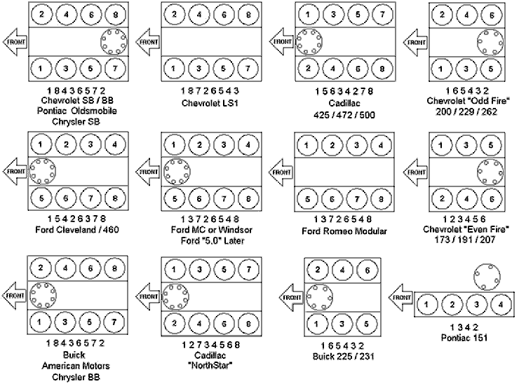

this help?

nope...i need to know where the plugs go on the cap not the engine

how bout this??

Find the no. 1 pos. on the cap and follow firing order clockwise all the way around.
