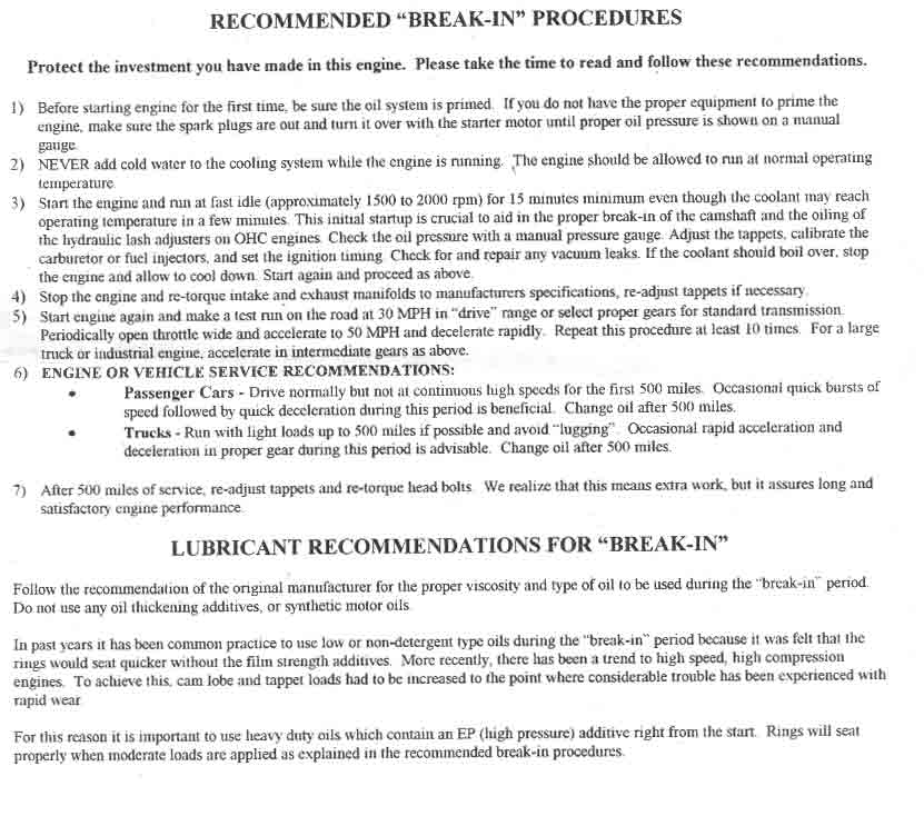

heres what the engine manufacturer says.
So many different ways.....which is best?
cheers
edit: adjust tappets? Why and what would that matter?
Solid lifters.
Old Feb 15, 2004 | 05:27 PM
x_wolf's Avatar
Joined: Nov 2002
Posts: 405
Car: 91 Camaro RS
Transmission: 700R-4
I have hydraulic lifters. This must be just an in general break in guide then. Does it still apply?
Old Feb 15, 2004 | 05:34 PM
Morley's Avatar
Posts: 4,099
With hydraulic lifters you shouldn't have to readjust after break in, unless you adjusted them wrong the first time around.

They came set from the guys that built it. I just put the block in and put a carb on it and hooked stuff up.
ok thanks. So does that guide sound like its pretty good? I'm so confused on the right thing to do.....
cheers and thanks
Old Feb 15, 2004 | 05:51 PM
Morley's Avatar
Posts: 4,099
Follow the mfg reccomendations.

hmm ok even though they say give it some hard acceleraton....will do.
