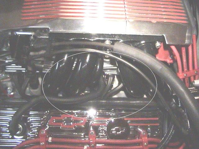

I have a vaccum leak that I cant find at all.....I though it was my CSI but that turned out to not be it. Its coming from the drivers side....I did the propane thingy and the rpm's go higher when I go over the area of the CSI and runner and rocker cover.......I changed the O-ring on the injector but the leak is still there. I also had to adjust my rockers so when I took the covers off and did that and put the covers back on...the leak seems to have gotten worse...or it may just be in my head...could the valve cover gaskets go bad? They have been on the car when I did my intake gasket 3 years ago...Im using the rubber gaskets...
or could it be my runner gasket on that side?
When I move the wiring harness of the drivers side injectors ( the ones laying on top of the cover running the length of the valve cover) it seems to cover the leak some how...or uncover how ever you want to put it......changes sound...
Im at a stand still........

here a pic of where its coming from..atleast it sounds like it...and when I move the injector harness it like uncovers the leak...or seems like it..

Ok guys,,,I found the problem, it was the runner gasket. THere was a part that I had to cut on it so the CSI would fit but little did I know that would cause I vaccum leak...luckly I had an extra one for that side last time I did the intake gasket...put it on and all is well...now the car idles like a champ..had to reset the IAC and TPS but that was no big deal...
Whew! Im glad it wasnt an intake gasket!
