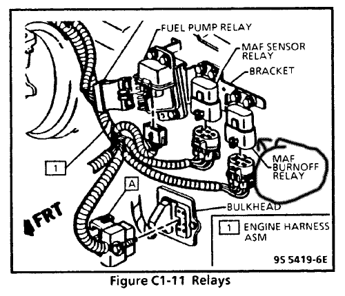

I just started getting the code 36 too. I tried to find more information on the MAF burnoff sensor in my manual but I couldn't find anything. Where is the sensor located?
Old May 14, 2004 | 10:53 PM
Trickster's Avatar
Posts: 6,127
Likes: 12
From: conway, s.c.
Car: 1989 Iroc-Z
Engine: 5.7L TPI

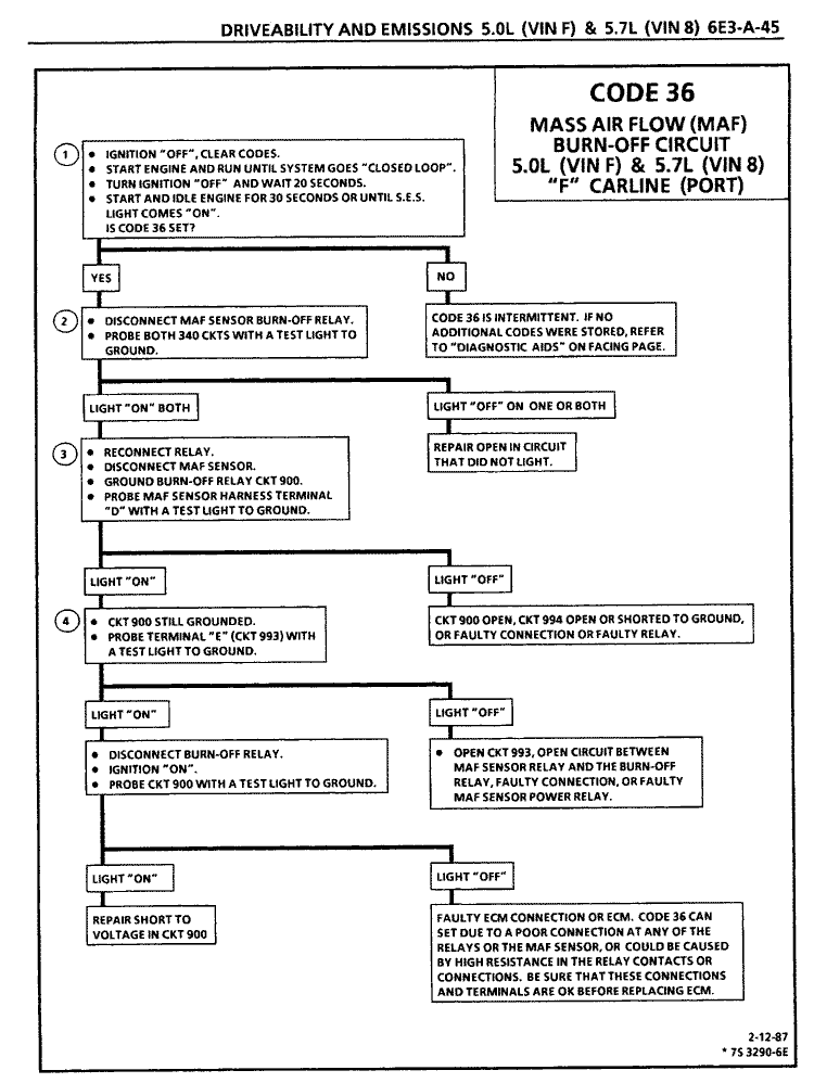

It isn't a sensor, it is a relay mounted on the driver side firewall. Here is some info on the code 36 problem you have. BTW, welcome to the board.

part 2
