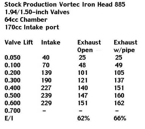

Flow chart
Here this is from:http://www.chevyhiperformance.com/techarticles/41598/

In that flow chart it ways "Vortec 885" ...what the heck are 885's? The only vortecs I've ever seen are 062, 906, and those other castings they put on 305's (I forget the casting #)
Old Mar 22, 2004 | 12:08 PM
AJ_92RS's Avatar
Joined: Apr 2001
Posts: 4,969
From: USA
Car: yy wife, crazy.
Engine: 350, Vortecs, 650DP
Transmission: TH-350
Axle/Gears: 8.5", 3.42
That's the old part # suffix.
They've changed part numbers since then.
