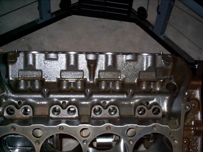

Ok, my friend gave me a 350 block awhile back, 2 bolt main. I had origionally planned to let it sit for later in life, and me do my 406 project i've been wanting to do, but prices on things lately have made me realize... i just wouldn't be able to afford the gas on the 406 beast.. So, i'm thinking of doing a 388, or 383, whichever i choose at the time. I have the block now.. But.. i'm having some trouble verifiying it's specs...
The casting # on it is 3970044. I have a book for buidling sbc's and the # isn't in there, and it's not on Mortec.com... um... i've checked the # twice... 3970044 is the #. So.. ya..
I wanna make sure it's a 350 & all that hoop la, & what it was in & such, i just want the specs on it.
If anyone knows anything about the casting # of this block, or a place where i may find out some info on the block, plz tell me.

Never heard of a 044.
Seen lots of 3970014s though. I'd expect that's what it really is. A very typical late 70s block; 76-80 or something like that, some came with 2-bolt caps, some they put 4-bolt caps on.
It came in a GM vehicle, probably a Chevy. Could have been a car or truck. Probably a car if it's a 2-bolt, probably a truck if it's got 4-bolt caps installed. Could have been a 2-barrel van motor, could have been a Vette L82. Doesn't matter any more anyway since no magic emantes from the sheet metal or even the fiberglass and endows the block with mystical superior powers, so I wouldn't even bother wasting another synapse firing on that sort of spank-off.
Specs are: 4.000" bore, "large journal" mains, predates the factory's roller Frankenstein, 2-piece rear main seal, driver's side dipstick. I have no clue what "specs" there might be besides those, which are things you actually need to know for something. Again, it doesn't matter what it came in, or what HP "rating" that motor had, or any of that; it's a block, not an engine.

That's what I was gonna suggest, plus.....
There's also a 3970041 that's a small journal 327, 2 bolt main from '65-'67
Triple check those casting numbers. They can be difficult to make out sometimes.
FWIW, the book I have says the 3970014 was only cast in 1972.
Mortec shows otherwise though.

Measure stuff. That's what I do. (Read my other post)
Measure the bore, then the diameter of the mains for the crank. That will tell you if it's one of the two blocks that AJ and RB mentioned.
If it's 014, have fun.
If it's 041, sell it.

Have you scrubbed the snot out of it with a metal wire brush?
I'm not saying you're wrong (well... yea I am
), but as RB said; It's HIGHLY unlikely.
I just happen to have a 014 block laying around, so I put black marker on the numbers and took a picture.
If this isn't what yours looks like then I don't know what else to tell ya except, measure.

3970044 is a VAN engine. It is a 1973-1974 chevy Van 350 w 150 HP. Usually a 2 barrel with 2 bolt mains.

www.chevymania.com shows 3970014 to be:
Casting Number CID Years .....HP...... Comments
3970014 ...........350 68-79 200-255 car & Truck 2 & 4-Bolt
But has nothing on 3970044

My bad guys...it was a 14 not a 44 (3970014)...
Anyway I've got the suffix code and its T0206CMR, when I looked up CMR all it gave was a code "A" under the Body/Comments. Does anybody have a clue what that means. I am trying to find out as much about this motor as possible. Thx

Forget the stampings. You have the casting #s. They tell you everything you need to know. There's nothing else to be learned. Those castings retain no memory at all of the sheet metal the factory wrapped them in. Castings are REAL DUMB that way. Takes them less than a second from the time you pull them out of the sheet metal, for them to forget EVERYTHING. Now, they simply are what they are, and it no longer matters what they used to be in.
You have a typical 70s 350 block, with typical 70s smogger heads on it, and the block came from a Chevelle/Malibu. Who knows whether those are the original heads that came with that specific block, and if not, what sheet metal was around the heads; but it doesn't matter, they're 882s. That number tells you everything there is to know about them. I've paid people to come haul them off of my property before.
All of those motors would have come with severely dished pistons, for about a 8.2:1 CR. You won't have any use for that crap, if that's what it has, it'll be going in the trash. They also all came with a 929 cam; 194/204, .390"/410". Dung. But you'll be throwing that away anyway too, so it doesn't matter.
You're wasting your time "finding out about this motor". It's a 70s smogger turd. Good block maybe; bad pistons, heads & cam for sure. Assuming of course that some 30-year-old motor is still in its original state. Which is HIGHLY UNLIKELY; there's probably a 99% or higher probability that it's been "rebuilt", which means that what's inside it has NOTHING WHATSOEVER to do with whatever the factory put there, and those worthless stamping codes are totally unaware of any of that.
This isn't the first time, and probably won't be the last, that the van guy is going to pop up here and make up stuff all about how his van has or does something totally unlike all the other vans - and cars and trucks - Chevrolet ever made. Too bad there isn't a van forum for people who care about those.
