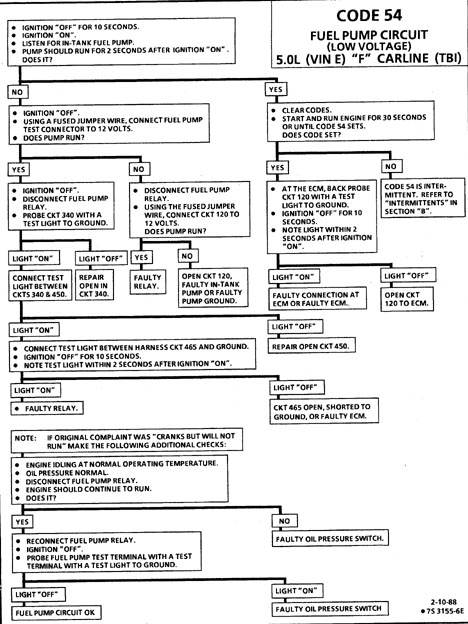

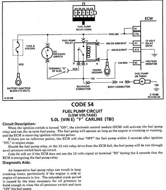

It basically means that the fuel pump is not getting enough voltage either through the fuel pump relay or the 12 volt driver in the ECM. Cheapest fix is new fuel pump relay.

here is the other half of my first post.
