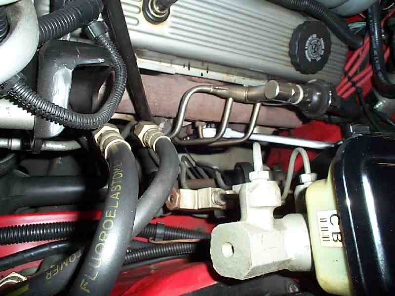

Geez. #5 is one of the easier ones on my car. I use a plug socket and short extension or flex-head ratchet.

What? My picture wasn't good enough? Need a video? Just get the right tools and get it from the top. I do all of mine from the top.

I do 7 and 8 from below, with the help of Rhino ramps!!!
....number 5 is a pain, but I've never actually had a "problem". I honestly don't know how I do it, but Vaders pic seems pretty much self explanatory. Mixing and matching extensions maybe? I dunno, like I said, it's never really been to much of a problem.
