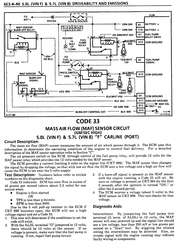

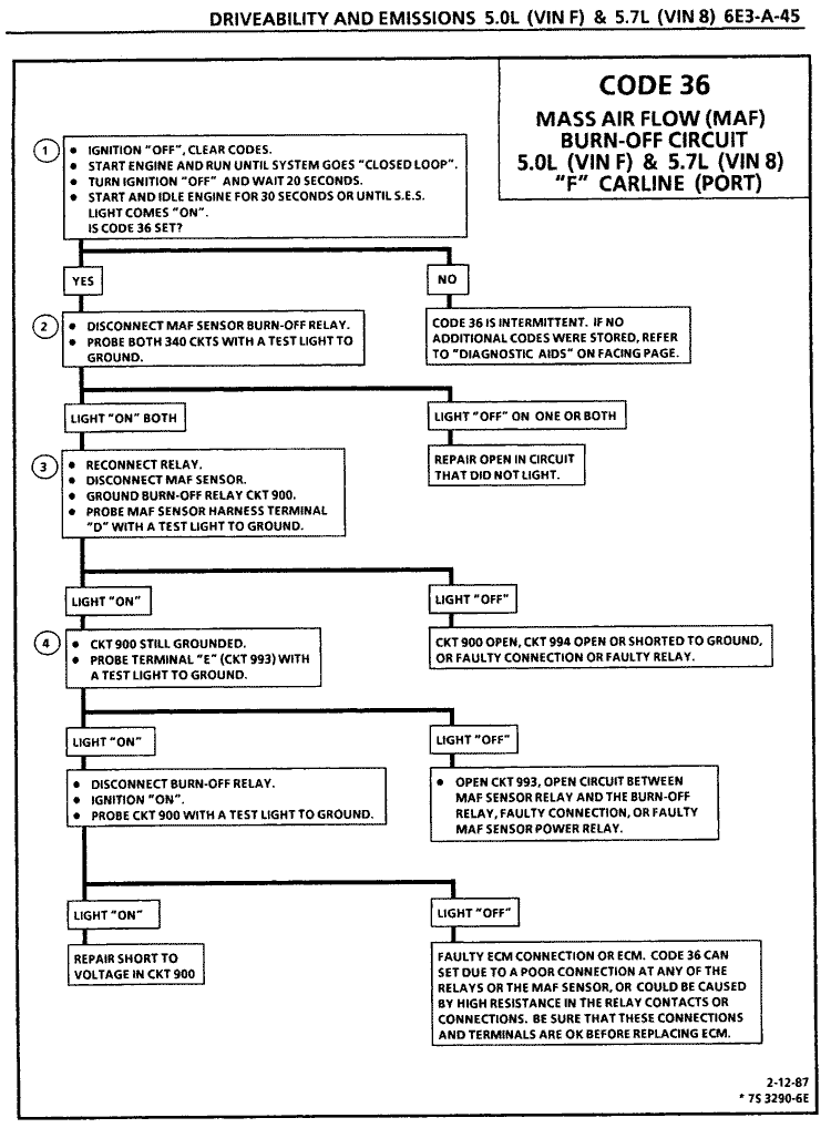

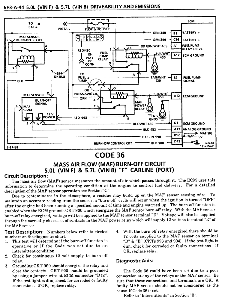

One, the code 54 = Fuel Pump Circuit (low voltage), that is why you didn't get it. Here are a some troubleshooting charts for codes 33 and 36 for you to look at.

Ok, got a test light and went through the flowchart. Here is what I got:
Jumpered ALDL terminal "G" to 12 volts. First time I did it, I could hear something(fuel pump I believe) coming on, but didn't get a good ground to use test light. Second and subsequent times, couldn't hear fuel pump, but test light came on.
Probed MAF harness terminals "A" and "B", both times light on.
I wasn't sure if terminal "D" should be checked with engine running or not. Checked both, VOM read about 0.06-0.07 volts both times. I took this to mean that it was "OK".
Terminal "C" read just over 5 volts when checked.
This leads to "faulty MAF sensor". Exactly what I didn't want to see. Now, after reading through everything I have gone through, would you come to the same conclusion? I have a hard time believing that I could have fried my MAF just by washing down my engine bay. While this could be the case, to me it seems unlikely but I could be wrong.

It doesn't neccessarily mean that you have a bad MAF sensor. You did not indicate if you checked terminal "E" of the MAF harness. Also, it says to check all associated connectors and wiring. Go back and check terminal "E" if you haven't already done it.
