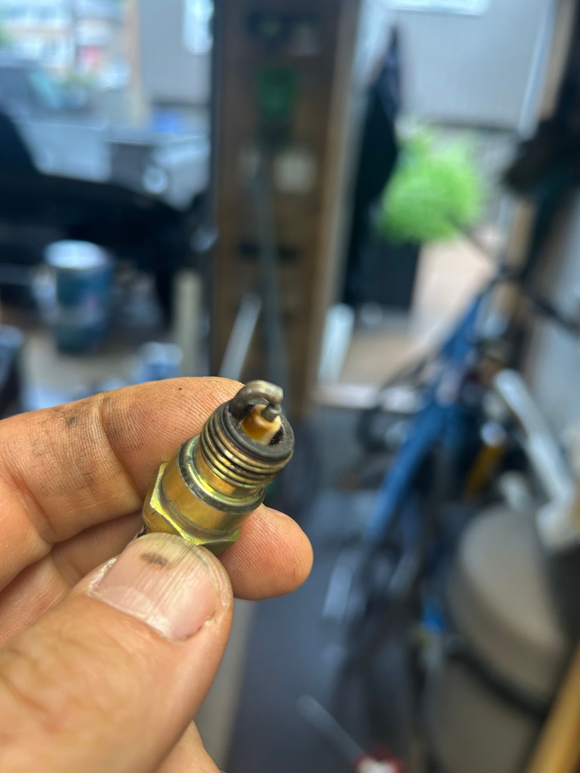

Old post I know but thought I’d add a photo of my spark plug condition. Distinctive brown spot on one side of the plug. White deposits on the side electrode.
maybe 5000 - 7000 miles on these plugs.
any thoughts?

Terrible picture, but that plug doesn't look bad to me.

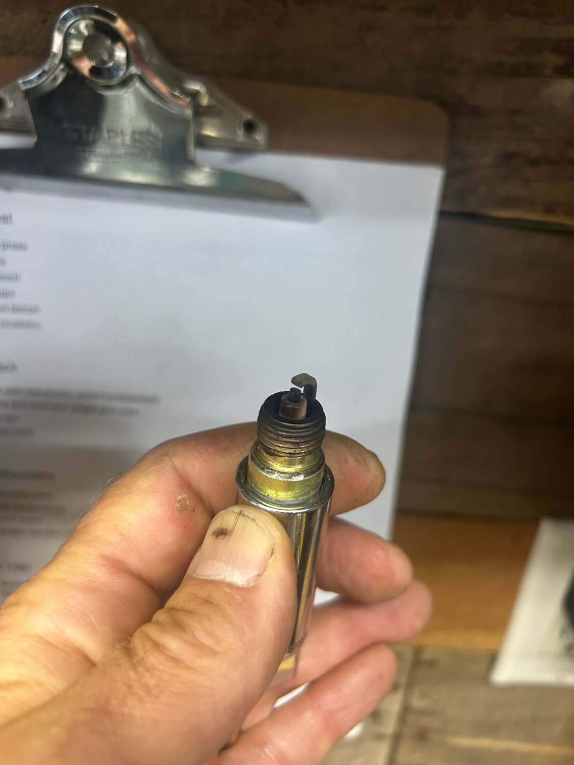

Thanks and sorry for bad picture. Was hard to grab. Here’s a different plug and even darker. Hopefully better pic.
Dark brown spot on one side.

That's a little better. The brown color is not a problem, and neither is one side of the porcelain being darker/lighter, either. It depends on the prevalent direction of flame travel in the combustion chamber that can cause different temps and what's burning where in there as the engine runs. Grab a good magnifying glass and check the porcelain and metal bits for any blistering or nodule deposition, which could indicate detonation. I'd not worry about those colors.

thank you for your time and your response.
