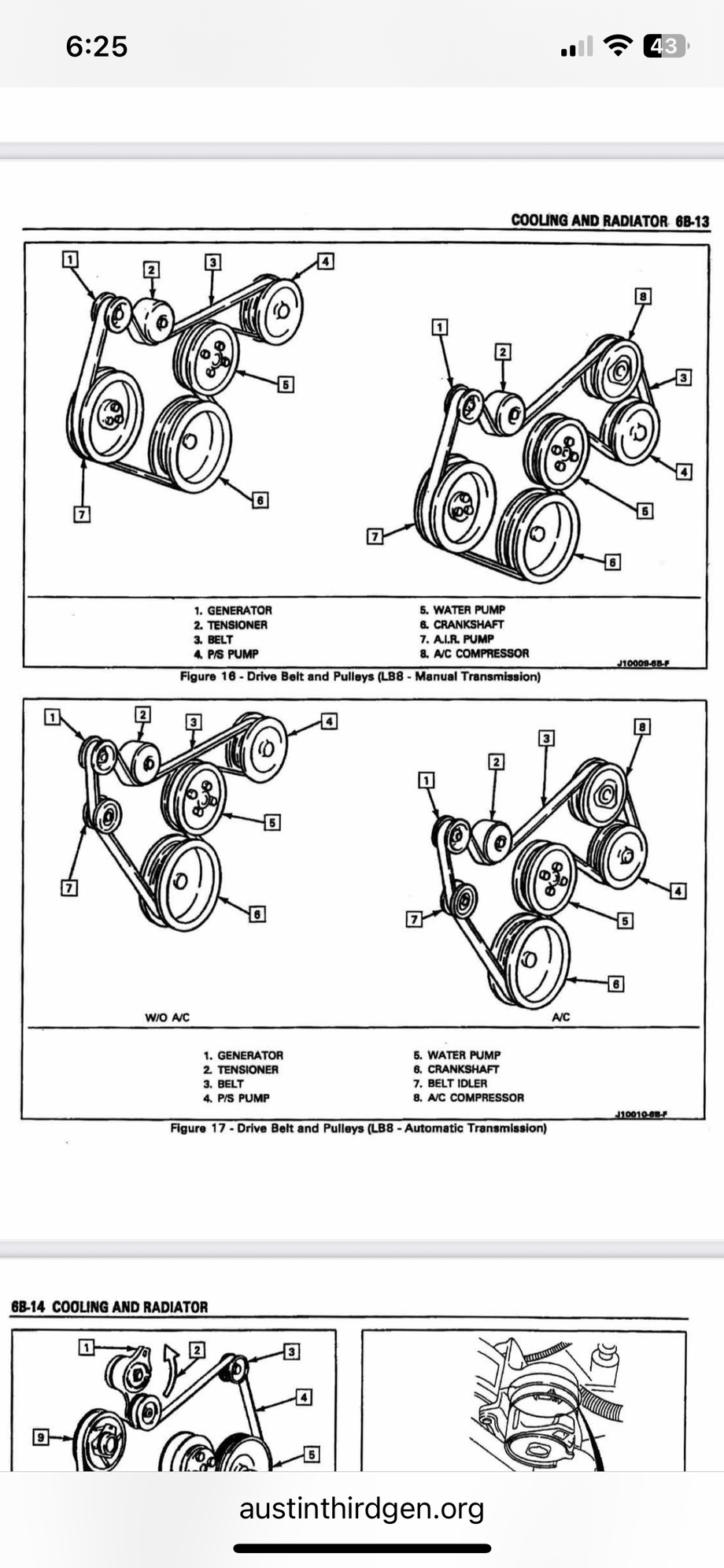

Re: 383 Stroker water pump recommendations
