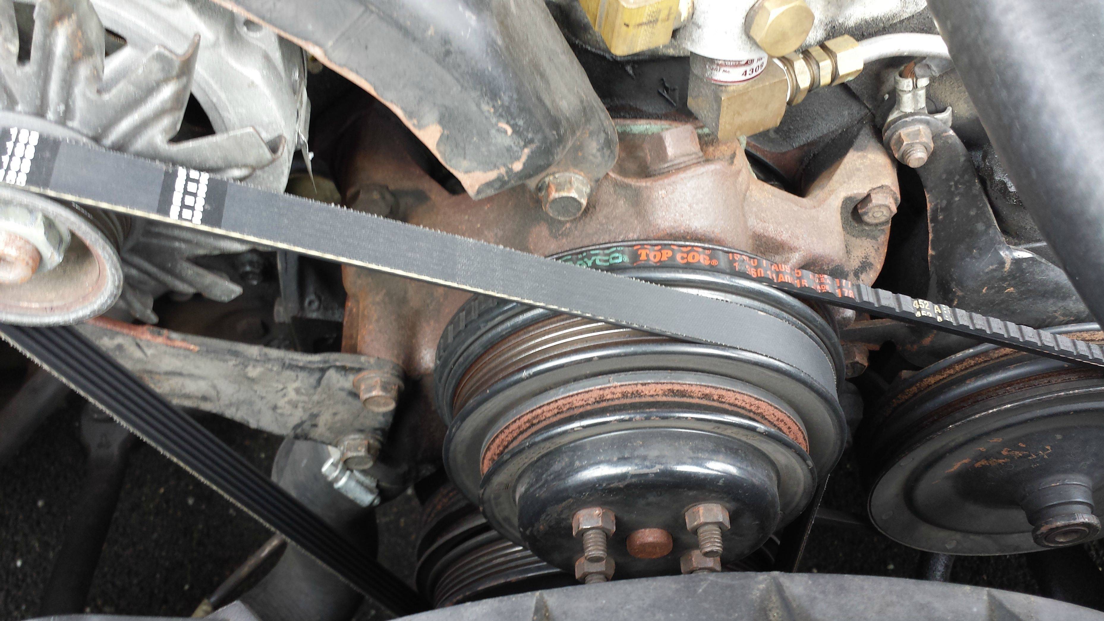

Re: What water pump do you use?
heres some pictures of what i got right now It looks like the long one
Yup; that would be the long kind.
Should; as long as it's set up for the correct direction of rotation. Which would be, clockwise, in the case of the motor in the pic. Alternatively, NOT for serpentine setups.
To me it looks like your water pump was changed. They come without paint on them most of the time. Someone was in a hurry and didn't take the time to paint yours. Is it leaking out of the weep hole underneath.
Not that I am aware of, I do have missing fluid though I have to top it up every week. I never have any puddles under my car
