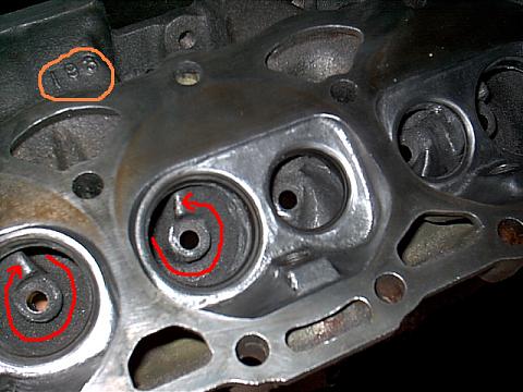

where would those be at? I got the car apart right now, in the middle of the cam swap actually.
This image was posted a bit ago by AJ, i hope he doesnt mind me reposting for him.
The arrows indicate the swirl direction implied upon the air flow by the tabs. The circle simply shows the 193 casting.

yeah, its smooth right there. well not completly smooth but pretty close to it. Does that give me anything better to work with?
Anything that is done to reduce the protrusions on the intake port increases flow. The only way to verify how MUCH it increases is by having them flow tested. So it will be better than before, how MUCH better, only a flowbench can tell.
If your heads have been bowl ported, the ramps may have been cut down enough to help the flow. It all depends on how much the bowls were opened, and how well the transition between the valve bowls and port runners was done. The top of this example shows stock "swirl" ports and partially cut down ports":
If yours were cut at least this much (preferably more) you may have decent flow. Another consideration is the chamber volume and piston design. Keep tabs on your final static compression and your goal.

Yeah, mine looks like that second picture you posted. I have flat top pistons and the compression is right about 10.5 :1. I just want these to be able to handle 350hp around 5200 rpm, and around 350 tq from about 2500 to 5000.
