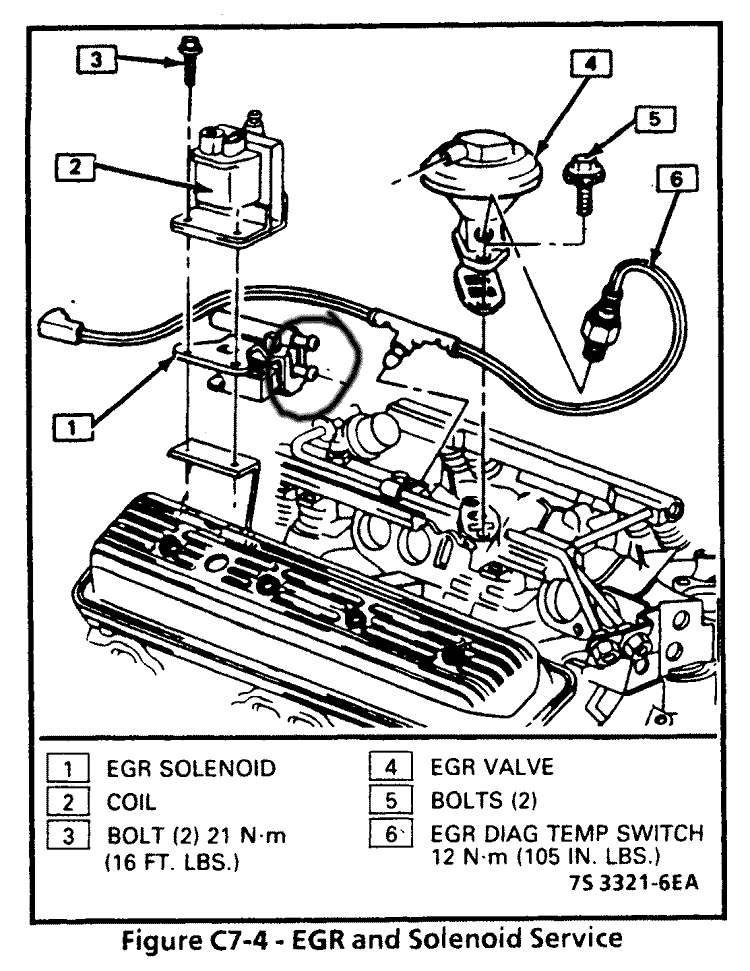

I have been struggling with an idle problem on my car for a year now and I don't want to take it to a mechanic, i'd rather figure out the problem myself. Well i might have found the vacuum leak that was causing the wierd idle but not sure. I found a small sensor looking thing under the ignition coil and there is a spot for a vacuum line to hook into but no line is connected or lying loose in the area. Any of you guys know what that sensor is and where the vaccuum line runs? Any help would be great, thanks.

That is the EGR solenoid, one line runs to it from the EGR on the manifold and another line runs to it from a small fitting at the base of the throttle body on the left side.

Thanks for the help, there are three lines though. One two go in one side and one goes out the other side. Mine is missing the one that goes out the other side.

There are only two open connections on the EGR solenoid. The third opening is a vent.

It would be the EGR valve and once they get carboned up enough, the only recourse is to replace it. It is item #4 in the picture I posted above. It is located on the intake manifold below the plenum chamber if it is installed. The reason the solenoid was unplugged and no vacuum lines running to it may be because some one has removed the EGR valve and put a blanking plate over its port.

Hey, Trickster - can you tell me which port goes to the valve or TB on the EGR solenoid? My new solenoid has one plastic and one metal nipple. I'm assuming the metal one is for the EGR valve?

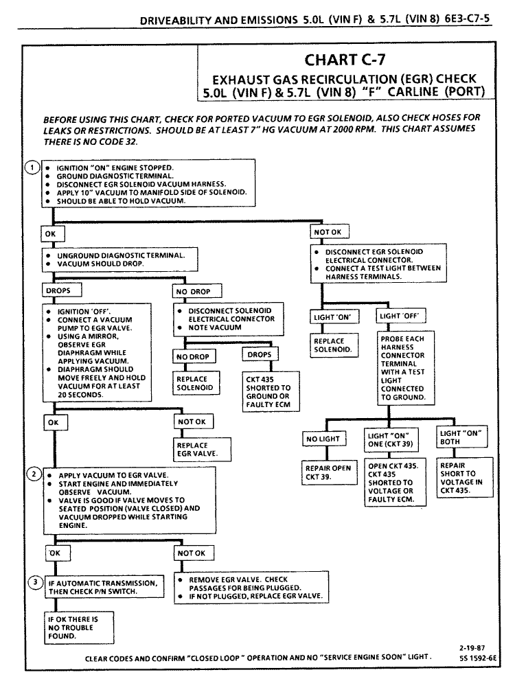

Hey Vernw,
Something like this maybe?

page 2

thanks for the attempt to help me but that diagram and instructions made no sense to me maybe some could explain in lymans terms. thanks guys i appreciate all teh help.

trueburton --- Did you connect the solenoid back up? If you replaced the EGR valve, we know you have one. Maybe the vacuum lines are not all connected, or connected the wrong way? That could be your vacuum leak...... (or a bad solenoid staying open all the time?)
Trickster - Thanks, but that doesn't show me or tell me which port on the EGR solenoid goes to the EGR valve and which one goes to the TB. Maybe I'm just a slow old Phat Phart, but I don't see it.....

Hey Vernw,
Look at the picture in my first post at the solenoid in it. The EGR valve plugs into the bottom nipple and the throttle body goes into the top one.

Okay trueburton,
In layman's terms, take a vacuum gauge and connect it to the nipple on the EGR valve and apply vacuum to it. While doing this, use a small mirror to observe the diaphram. It should move freely and hold pressure for at least 20 seconds.

Vern,
It doesn't exactly tell you that in so many words. If you look at that picture of the solenoid and EGR valve. You will see a broken line coming out of the bottom nipple and a broken line coming off the EGR valve. This broken line signifies that the two components are physically connected in that manner.
