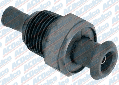

It was as I suspcted, the connector was loose. I finally found the temp switch with the help of some small mirrors since it's tucked good in below the manifold.
THe connector was all brittle and just crumbeled to dust as I tuched it. So now I need a new connector and possibly a new temp switch.

THey stocked alot of parts, but didn't have the connector I need. A universal connector won't do either. I found the temp switch, and at least that's ok now that I know what it's supposed to look like:
