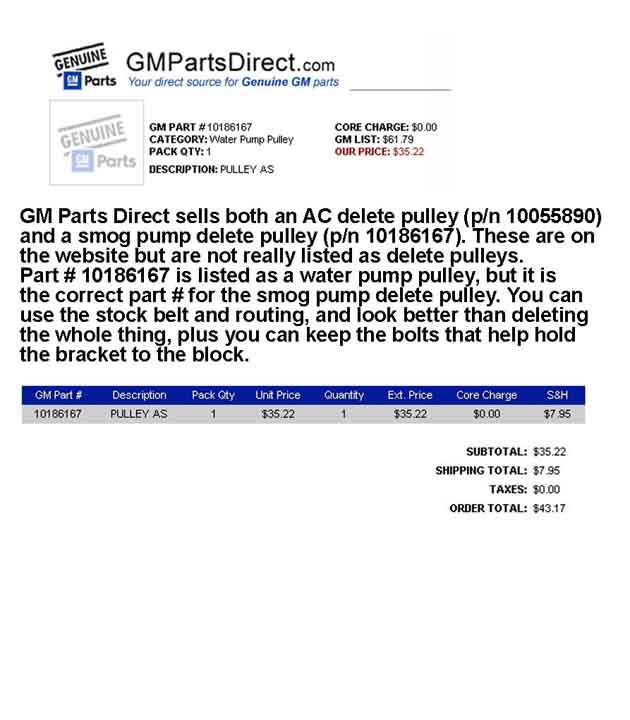

Using the Smog Pump delete pulley lets you use the stock belt, avoid excessive belt flex, and retain the two bolts holding the belt support bracket to the block. If you run high rpms, you need this. But I'd still like to know the difference between the two serpentine belt routings, if anyone knows ... please.
Attached Thumbnails Smaller water pump pulley for 88-92 Serpentine drive sys.-smog-pump-delete-water
