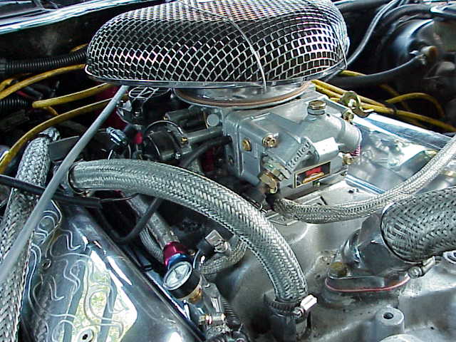

Carbed 350 stumbles on acceleration???
In my sig is the set up I am running right now. When I get on the throttle it stumblesover itself for a second and then straightens out. What causes this??? Carb adjustment? Or timing?? please help! thanks

Your carb may be out of adjustment OR
your fuel pump may not be delivering enough fuel Try running a stronger fuel pump for that bored over motor

fuel pump isn't the problem. make sure your throttle blades are adjusted right, as well as the idle mixture scews.
the problem is probably the accelerater pump cam, or the squirter. try a shorter and more aggressive pump cam profile, or step up to a bigger squirter on the primary side.

I'd strongly suggest getting the throttles closed all the way, before messing around with the accel pump.
Take the carb off and turn it upside down. You will see a couple of hloes and slots on the front side of the throttle bore, that the blades cover and uncover as they transition from idle to open. You will notice that there is a long vertical slot. That slot is called the "off-idle transition slot". (Sound sort of like what you're having trouble with?) The front edge of the primary blade should be below as much of that slot as possible. You accomplish this by adjusting the secondary idle stop screw, which is only accessible from underneath, in most Holley carbs. Open the secondaries with that screw until they are nearly as far open as the primaries now are; then back the primary idle screw out until the throttle blades are at the very bottom of that slot.
Put the carb back on, see where the idle speed is, tweak it as required, and re-adjust the idle mixture as necessary; drive the car, and see if the off-idle transition is any better than it was. If the idle is too high even with the screw backed all the way out, pop it back off, and back of the secoondary one a little; keep it up until you get it right.
Then see this thread https://www.thirdgen.org/techbb2/sho...hreadid=244930 for instructions on how to get it to run right and get good fuel mileage.

alright I did all of this and set it on the engine and came out with about the same idle as I had when I took it off. Anyways it cured part of the problem but the stumble is still there.

Update! I still have the stumble along with lots of black smoke coming from the exhuast. It never did this until I adjusted the secondaries. Even with the idle mixture screws it still doesnt cut back on the smoke. What do I do now???

Replace the primary power valve. Make sure you use the right PV gasket.

The power valve is already gone??? Damn it I havent even run this carb for a week yet!! What a PITA, thanks for the help.

One spit-back through the carb can pop it.

"Which one to get" is a tuning thing, determined by your carb's jetting and idle vacuum. I'm guessing, just looking at your motor, that by the time you get it all dialed in right, you'll have about 10-11" of vacuum idling in gear; so I'd try a 8.5 PV first and see how that goes. Check your vacuum to make sure, and get the one that's about 2 numbers lower than your idle vacuum. One that's too low of a number will cause a big flat spot off idle, if the carb is jetted for modern street driving.
There's a "PV blowout preventer kit" you can get from Holley. It's a kind of check valve thing that goes in the vacuum passage that leads to the PV. Some carbs come with it already installed, but most don't. Especially older ones.

Well to my amazement my carb already has the check ball thing installed. I find this out after I recieve my checkball parts

Go ahead and change out the PV and go from there. You might want to have an assortment of them to try out.

I need some more help I am gonna pull the carb off and give it one more try. what I need you to help me with is setting my jetting or atleast getting me started in the right direction.
Here are the specs for my carb,
700cfm,
Primary jet-122-69
Sec jet-122-78
primary power valve-125-65 but I changed it to a 8.5 PV after you suggested it
Primary discharge nozzle-.028
Do you think my jetting is alright or should I start with something new? I am willing to try something out cause this stumble is driving me nuts and the car is using ALOT more gas than it should be using.

What's your vacuum idling in gear? You probably want a PV about 2" below that. The 8.5 PV should be good for idling in gear vacuum of about 11". If the vac is higher than 11", raise the PV; if it's lower, lower it, because it's probably opening at idle, and that will definitely make it too rich.
Tune your primary jets for good mixture cruising (probably close to 14.7:1, but who knows); and tune the sec jets for best ET.

Wow, 78 secondary jets are huuuuuge. This likely accounts for your WOT issues.
Think about going down to 72 secondary jets for that engine and setup.
The ideal way to do jetting is on a dyno with wideband O2 sensor. The less-than-ideal way is reading plugs.

Good idea, and start gathering up jets. Like I said, 78 is a gigantic secondary jet for a bored-out 350. Biggest I've seen on a 350 is 74, and that was with 70 primary jets...on a 650cfm Holley double-pumper.

Old Aug 11, 2004 | 08:43 AM
  #44
BIGJON's Avatar
Joined: Aug 2004
Posts: 139
Car: 1989 Formula 350 Firebird
Transmission: 700 R4
I had this problem with my Edelbrock carb. I just found a buddy with a similar aftermarket carb and threw it on and there was no stumble. That way I new it was the carb. So I rebuilt the carb and no more stumbling.
