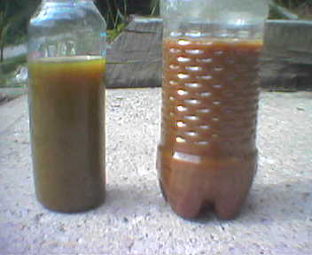

Update......
well last night we flushed it as best we could....we ended up taking the rad out and flushing it with hot water and a leaf blower (it helped ALOT, just hope it didn't mess anything up) and we put it all back together, so far it's good but he only drove 5 miles....anyway here's the pic of the antifreeze....
1. on the left it what was in the rad after letting it sit and cool down
2. on the right is after the car ran for a few mins to mixed it all up.
and after letting both bottles sit u could see the neon green coolant at the top brown in the middle and a redish brown crap at the bottom, like rust . (not shown in pic)
BTW this is after only 15 miles of driving after we did the last flush

Old Jul 17, 2004 | 01:51 AM
Red Devil's Avatar
Joined: Apr 2000
Posts: 3,187
From: E.B.F. TN
Car: Tree Huggers
Engine: Do Not
Transmission: Appreciate Me.
Pull some freeze plugs, pop off the thermostat and flush that thing out good. Then use DISTILLED water / coolant mix 60/40 and a bottle of Water Wetter. Good luck!

well we pulled the drain plugs in the block and took the stat out and the engine ran clear in a few mins, that's how we knew it was the rad...so after an hour of flushing the rad every which way, we ended up taking it out (never relized how easy that was) and flushed it with hot water and it finally came clear for the most part. i'll find out tomorrow (well later today 3:30 AM eastern) and i hope it still good. we threw a new stat in while we were at it and the old one did open but now very well and not all the way. so i'm sure that had something tot do with the overheating

Pics are always nice.
But yes thats rust. Usually taking the radiator out and flushing it alone wont do too much since its aluminum. Aluminum doesent rust out. The rust is comming from the engine block its self. You really need to get the rust out, when it gets like that its a loosing battle. My brothers windstar is in the same condition. There are quite a few rust and scale removers that can be added to a cooling system that will remove the rust but its usually not somthing that is done in one shot and most of the time somthing gets plugged and needs replaced, heater core, radiator.
I'd check around marine supply stores and such and see what they stock for rust removers.
well we flushed the blocka dn it was fine...clean water came out the water pump and the drain plugs in the block....but the rad had ALOT of crap coming out, so that's y we focused on the rad, it was all coming from the rad. i have another pic of the fluid of it sitting for a day and......wow, i'll have to upload it asap
