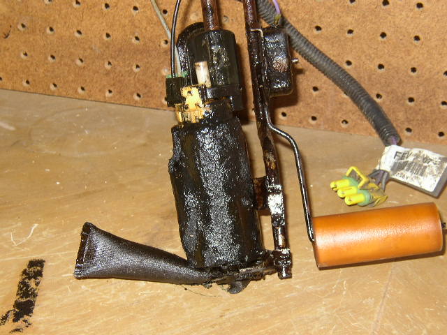

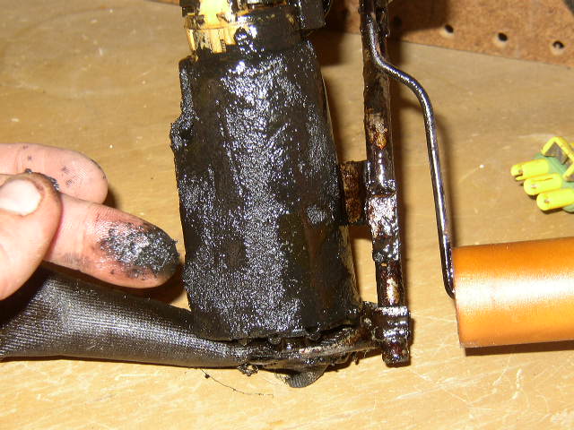

Well, I just got done putting the new fuel filter, But when i took off the old filter i really didnt get any gas from the gas line, I thought i could turn the car over and the gas from the gas tank would shoot out of the gas line but it didnt.
Is it supposed to squirt out the fuel line????
If it is i'm guessing the fuel pump is no good?
I also left the old gas in it, I cant syphon the old gas out or cant get it to come out the fuel line so i lelf it in there and add some fuel cleaner stuff..

Don't know what that crud is, but since you already have the tank dropped, I'd take it somewhere and get it cleaned out.
While you're at it, blow out the fuel lines with some air to. Hopefully they aren't full of that crud.

Just looks like a typical old gas tank to me. Except, usually that stuff when I've seen it is more brown, than black. Maybe some local variant of your gasoline additive package is dofferent from mine.
Nobody ever believes me when they post classic fuel starvation symptoms, and I tell them it's probably crusties in the gas tank.....
I doubt that compressed air will get that out. You'll probably have to rod it to get it out. Coat hanger wire works great.
