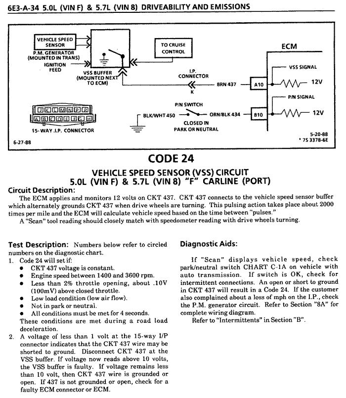

Your code 54 = Fuel pump circuit (low voltage) and your code 24 = Vehicle Speed Sensor (VSS) and can be set if there is not constant voltage on that circuit. Just a thought

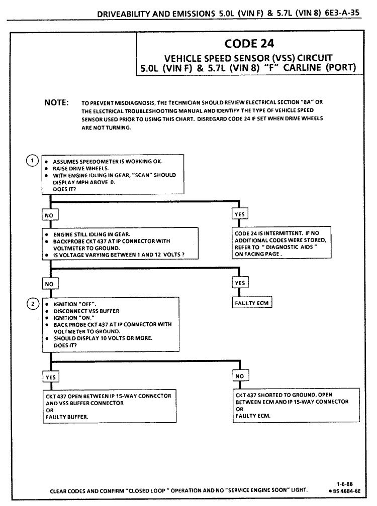

page 2
