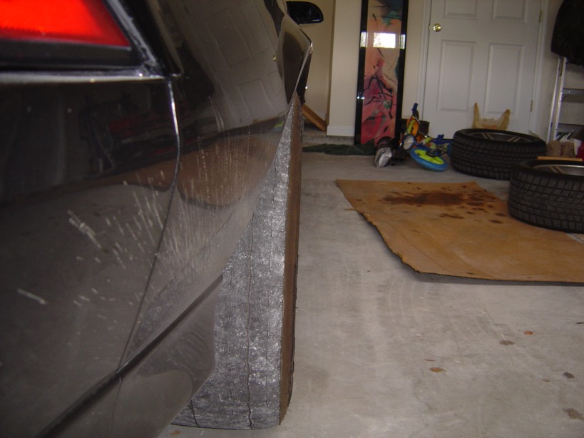

15 x 9 Weld Draglites, 5.5" bs. They tuck nicely but like mentioned above you can get away with a 4.5" bs and shouldn't stick out much. I do run a 5/32" spacer in the rears to clear the PBR calipers....if I didn't use the spacers then they'd sit in more and a 4.5" bs might be better.
15 x 3.5 Draglites up front...1.75" bs is the only one available with this size.

rear

IrocZZ3 those wheels look great, ChrisFormula355, Best thing you can do is take off your wheels and do some proper measuring, it's not that hard to figure, then whatever you do don't let the wheels protrude from the wheel opening ANY, nothing looks worse on a Third-gen than wheels sticking out past the fenders!!
