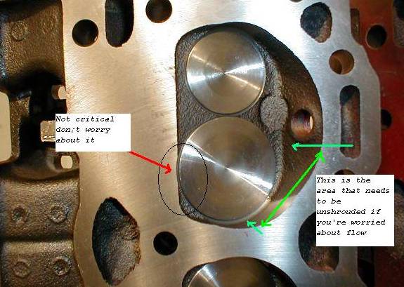

Question - it seems that the Intake valve isnt even sitting
inside the bore, looks like its just on top, so you're not getting
maximum efficiency out of those big valves ..
The intake valve is slightly out of the combustion chamber.
Are my observations correct ?

I noticed the same thing about that intake valve. Also, the valves are surrounded by so much metal that is you wanted to unshroud them you would probably be right back at a 64cc chamber if not more.
It is still within the bore. The bore is round while the combustion chamber is often half-circle or wedge shaped.

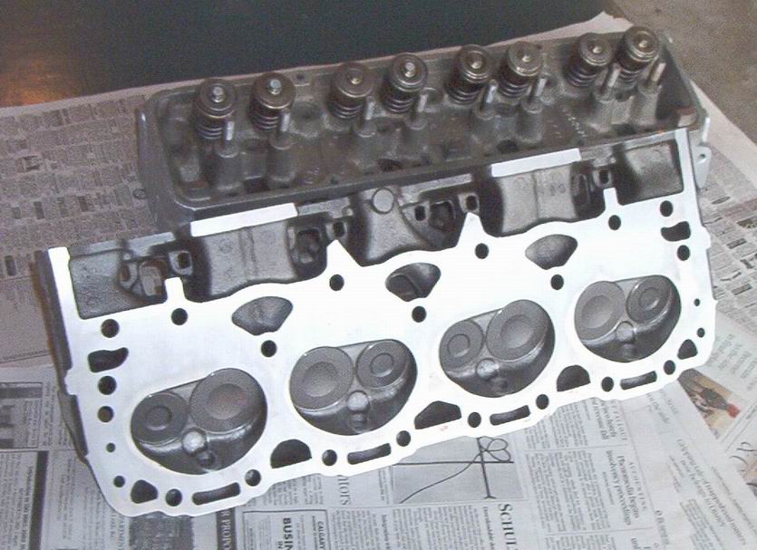

Here is a pic of my 601s with 1.94" intake valves, which you can see extend well past the combustion chamber but still fall within the bore.
Attached Thumbnails ''performance'' heads on ebay-resize-finished-heads3.jpg
