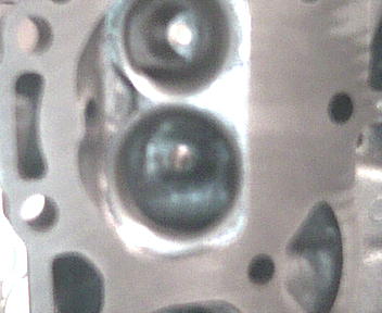

Don't pay some one to port your 305 heads (434).
Do it yourself. You cannot hurt these heads.
If you thouroughly port them following my, Sitting Bulls and others advice from past posts you'll get good results. They will need a full on port job. All it takes is time and elbow grease.
Then take them in for machining etc. You can pin the studs to save money. A hi perf stock spring set is good for .510" lift cams. crane 99846 comes to mind. Shorten the guide boss and equalize the installed heights (shims)
Use new 1.94 x1.60 valves not 2.02's.
Buy a book by David Vizard on preparing small block chevy heads. All the info in there is relievent to porting 305 heads.
It's just not cost effective to pay some shop to spend the time nessessary to properly/ completely port these heads. When you can do it yourself at home. It takes too $$$$long.$$$$
